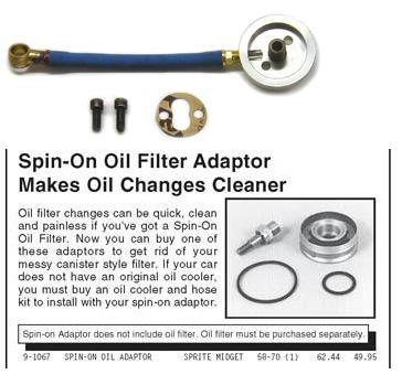

Speaking of which... Does anyone know what the difference between the Moss spin-on adapter and the Vicky Brit spin-on adapter is (other than $50)?
Well looking at the catalogue, Vivy bit (49) requires an oil cooler to be bought for an extra hand full of cash (>$150), but the Moss one ($98) does not require an oil cooler. Little British Car Co. carries the same adaptor for $84.

Hmmm... I'm not sure what the difference between the two could be that would require an oil cooler with one and not the other. For that matter, I can't imagine why a spin-on adapter *would* necessitate the need for an oil cooler.
Here is a pic of the moss (top) adaptor and the vicy bit adaptor (bottom) I guess the moss changes the pipe from filter housing to block, while the vicy does not, but how it works I cannot tel from the image.

I installed the Vicy Brit part last night (9-1067) uses a FRAM 933 or equivelant filter. Took 10 minutes. I bought it local paid $80 Canadian but no shipping and no waiting it was in stock. The oil leak seems to have stopped. Much happier now. Now I just gotta drain out all the bad gas. Any idea on the best way to do that?, Just disconnect the fuel line at the fuel filter and run the hose into a container and turn the key on and let the fuel pump do its thing?? I guess I have about 2 gallons of gas to pump out. The guage reads empty.
