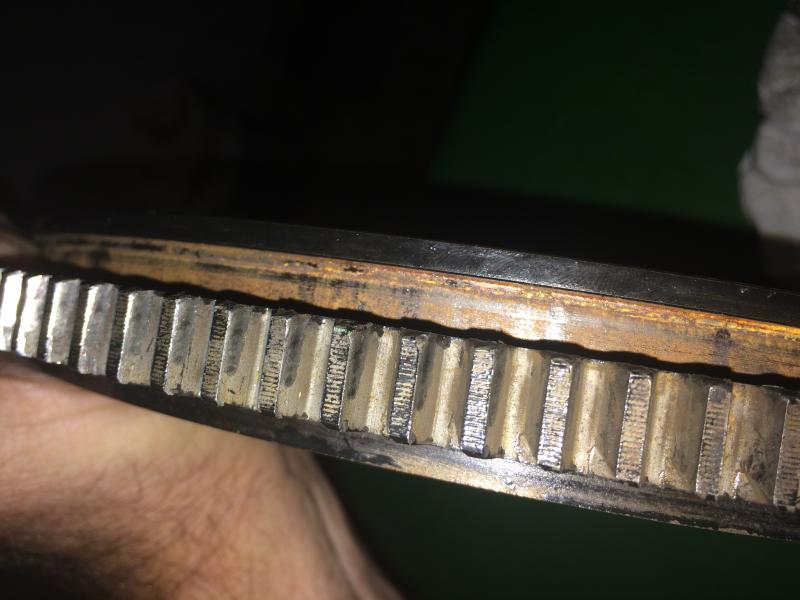

I had the exact same problem a few years ago. Mine turned out to be the ring gear. It moved away from the shoulder on the flywheel causing the starter not to engage.
This may not be your problem but it’s one thing to check.

I didn't say "missing teeth".....The problem I had with the starter was that the ring gear moved away from the starter on the flywheel.
The shoulder of the flywheel is at top of pic... the ring gear moved quite a bit making it impossible for the starter to engage in the ring gear.
