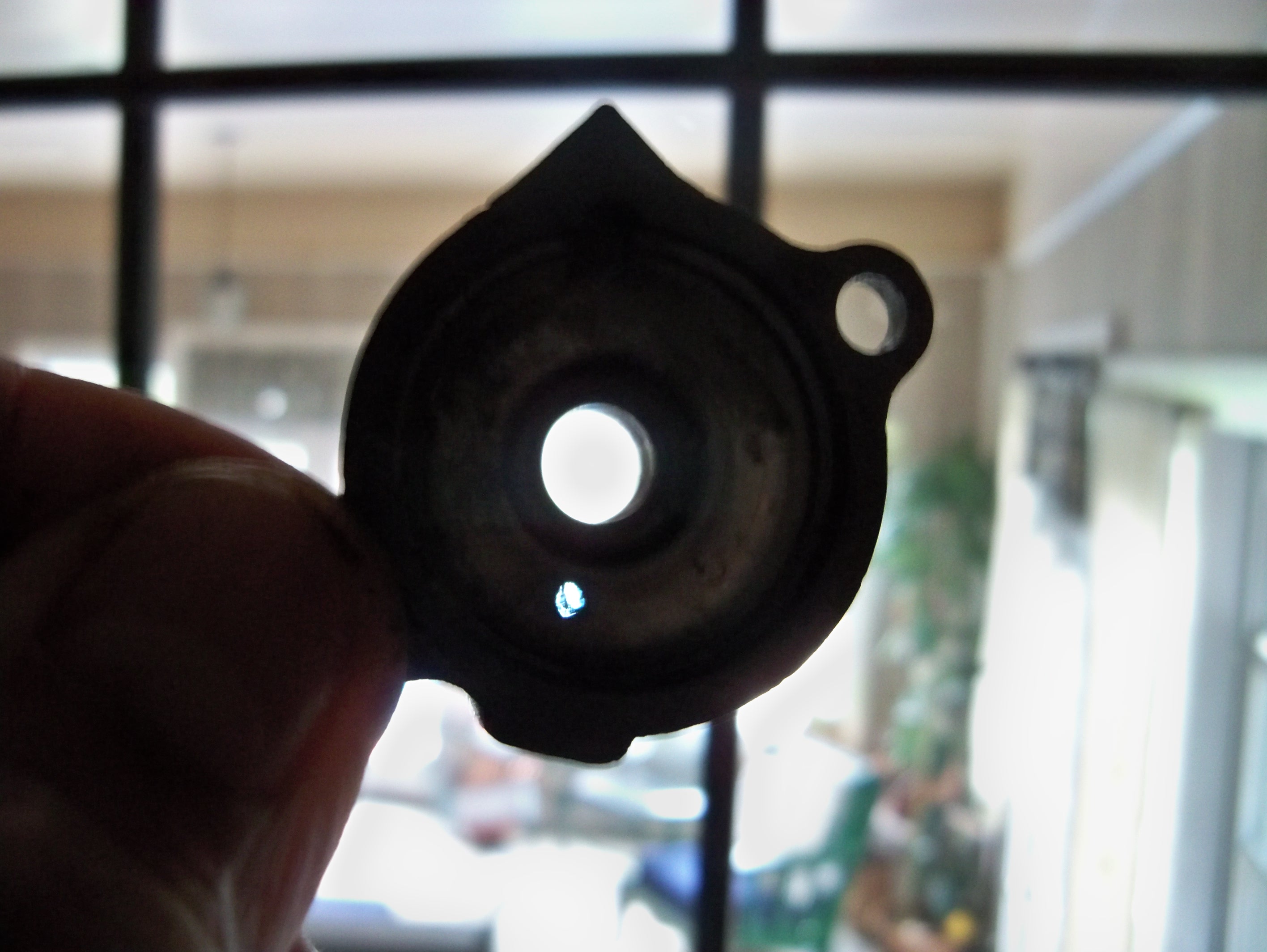

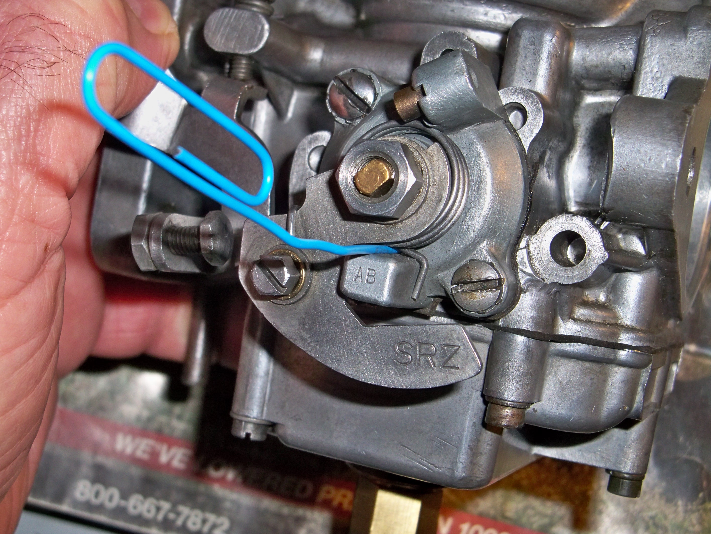

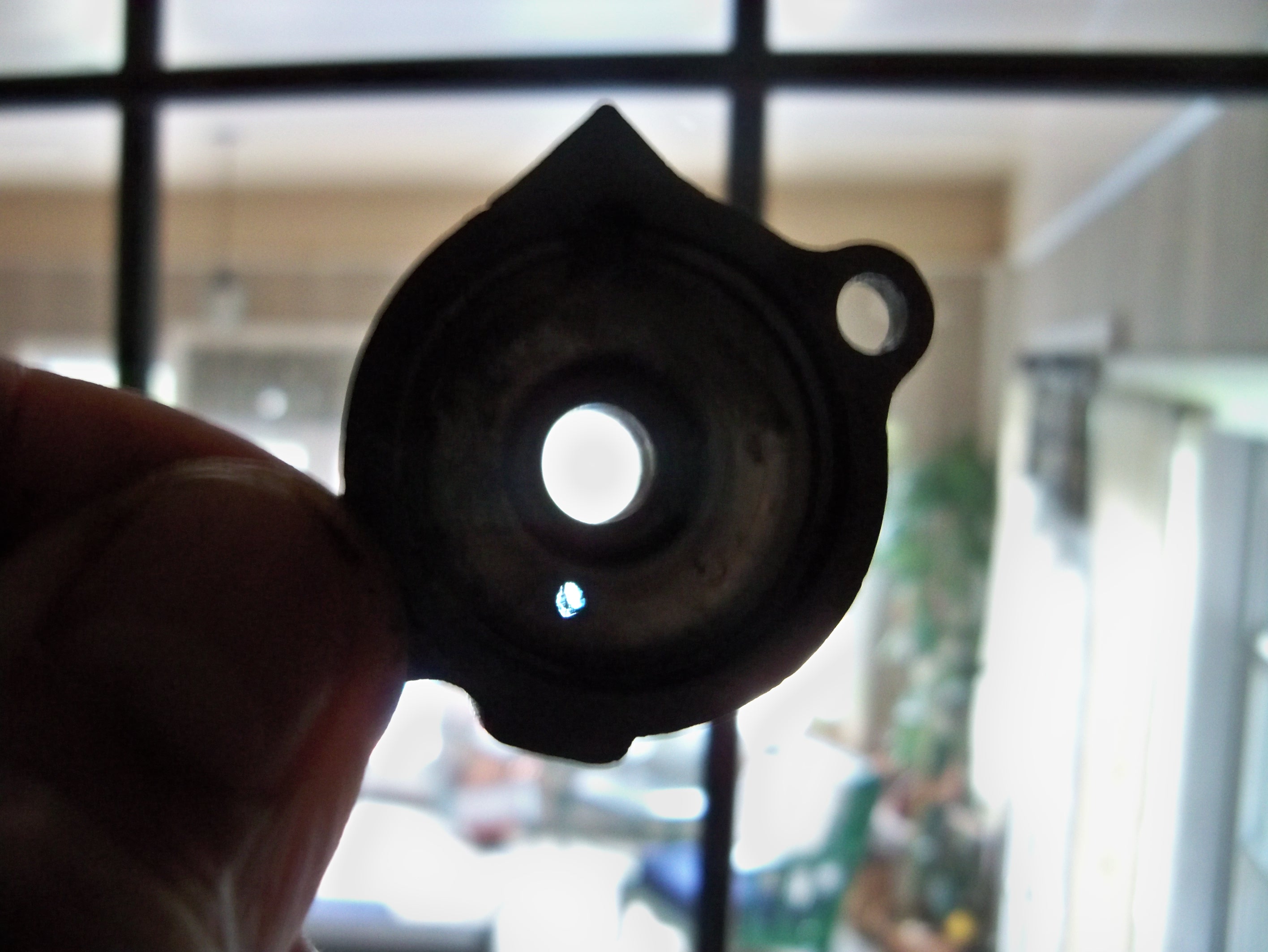

There is an obscure 'weep hole' and that's likely where the gas is coming from.

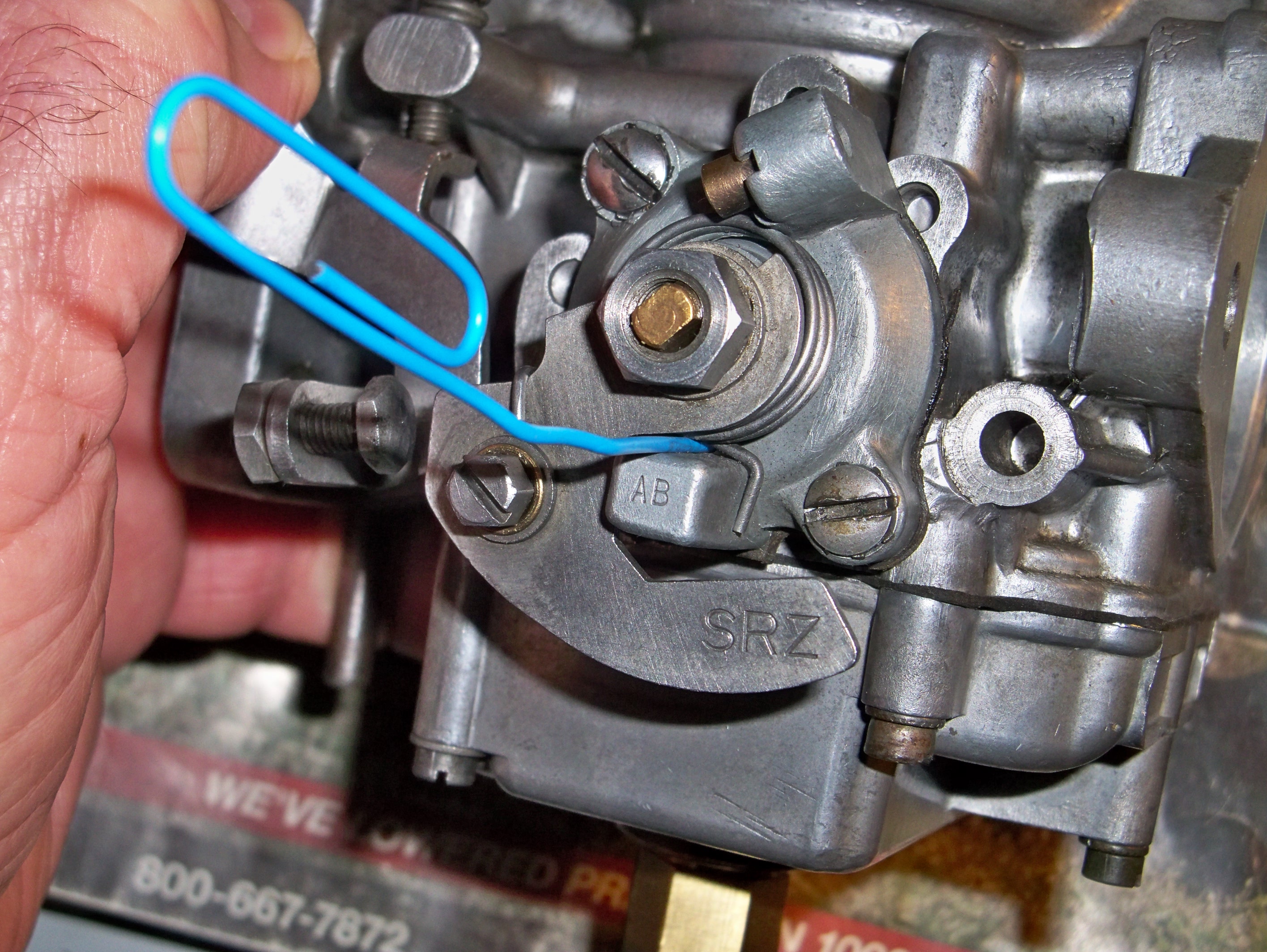

There is an obscure 'weep hole' and that's likely where the gas is coming from.View attachment 91259
great pictures, but I don't understand the pic with the paper clip
poolboy
The paper clip is actually sticking into the otherwise 'obscure' hole.
It's the same hole that is clearly visible in the silhouette picture
Dahhh, thanks...I don't think my hole was that big with my carb. I have the carb where you have to take the piston out of the carb body to adjust the fuel air mixture.
Yeah the hole is that size in your carb's starter boxes...they all are.

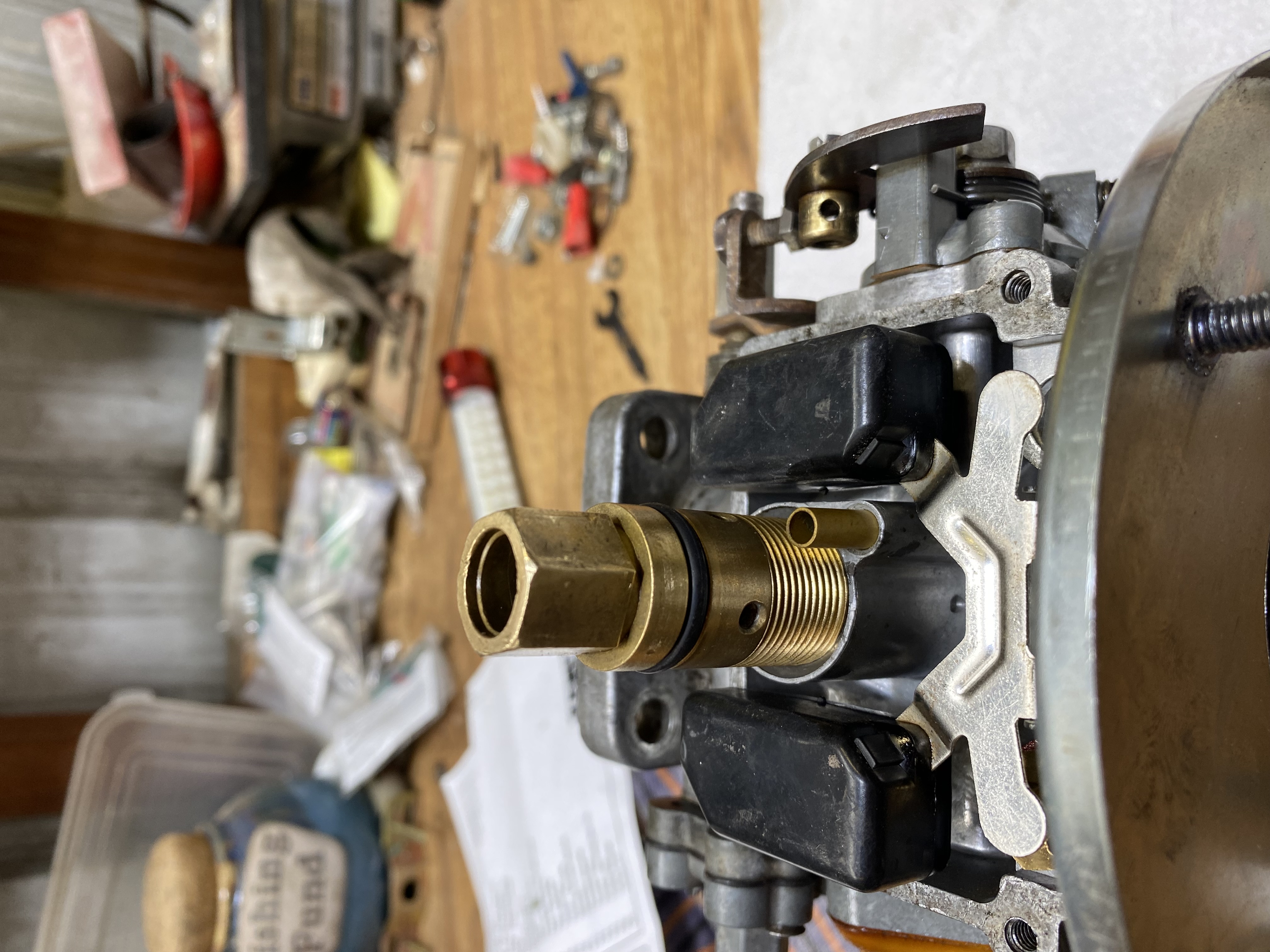

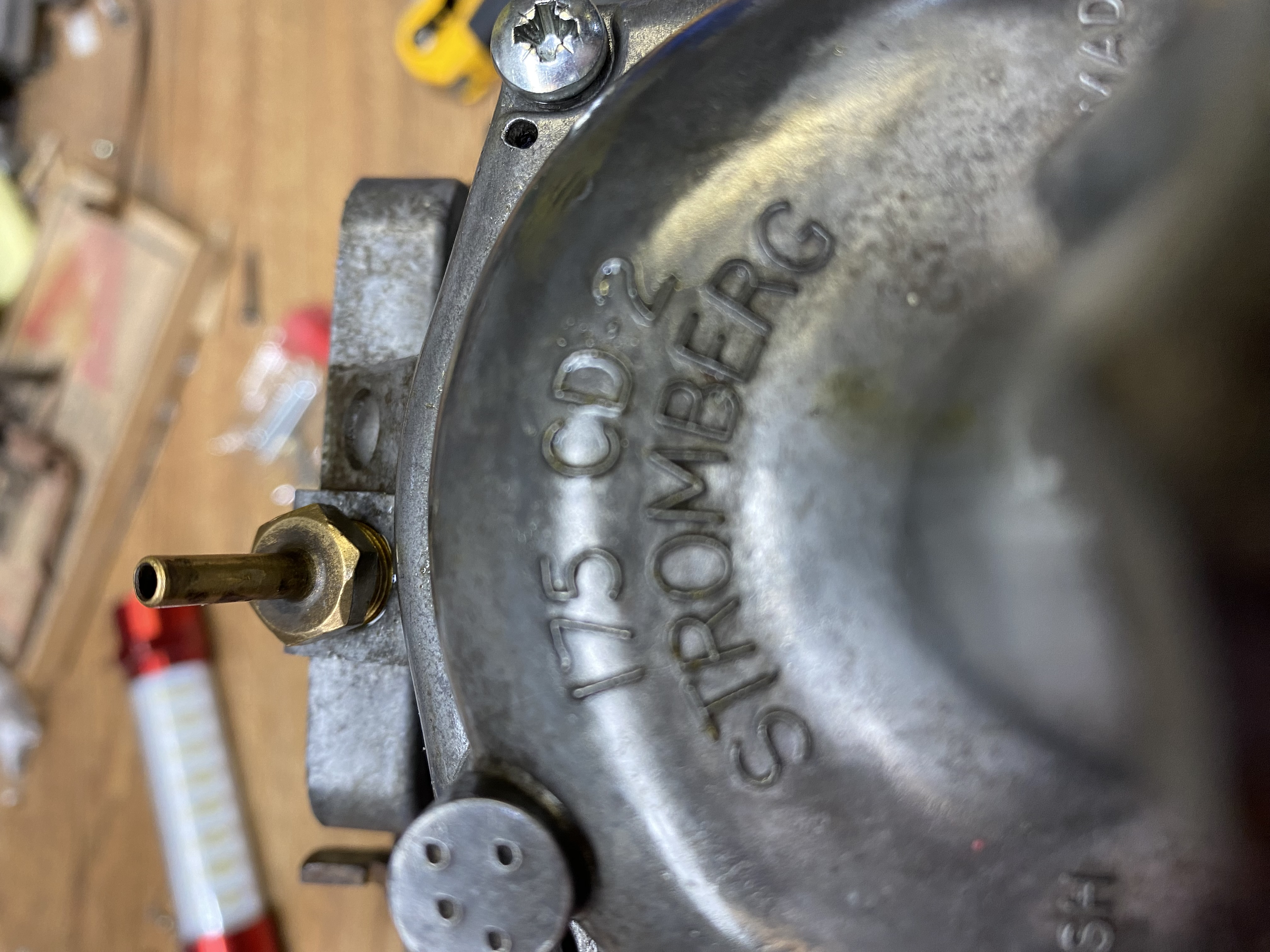

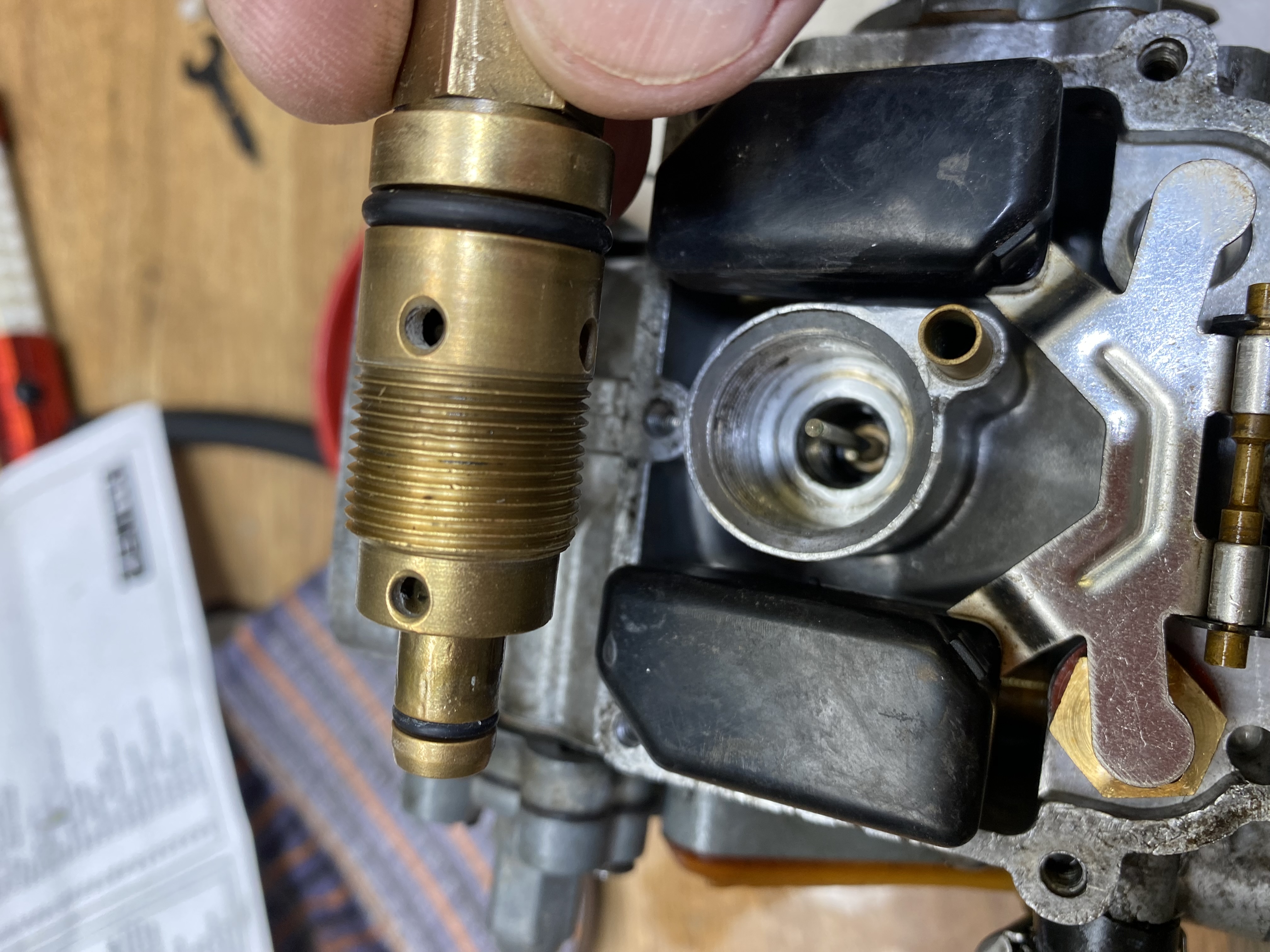

Now my carburetor nearest the radiator is leaking through the bottom of the jet plug. Any suggestions. The car is running better than ever, if I can just get the leaking to stop.
poolboy
It could be as simple as cleaning the hole and replacing the O-ring...that is if the leak is just gravity related and an O-ring
It could also be due to an over filling float chamber and the fuel is being forced out.
I'd check those black floats for buoyancy and if they float evenly put them back in and set the height at 17mm.

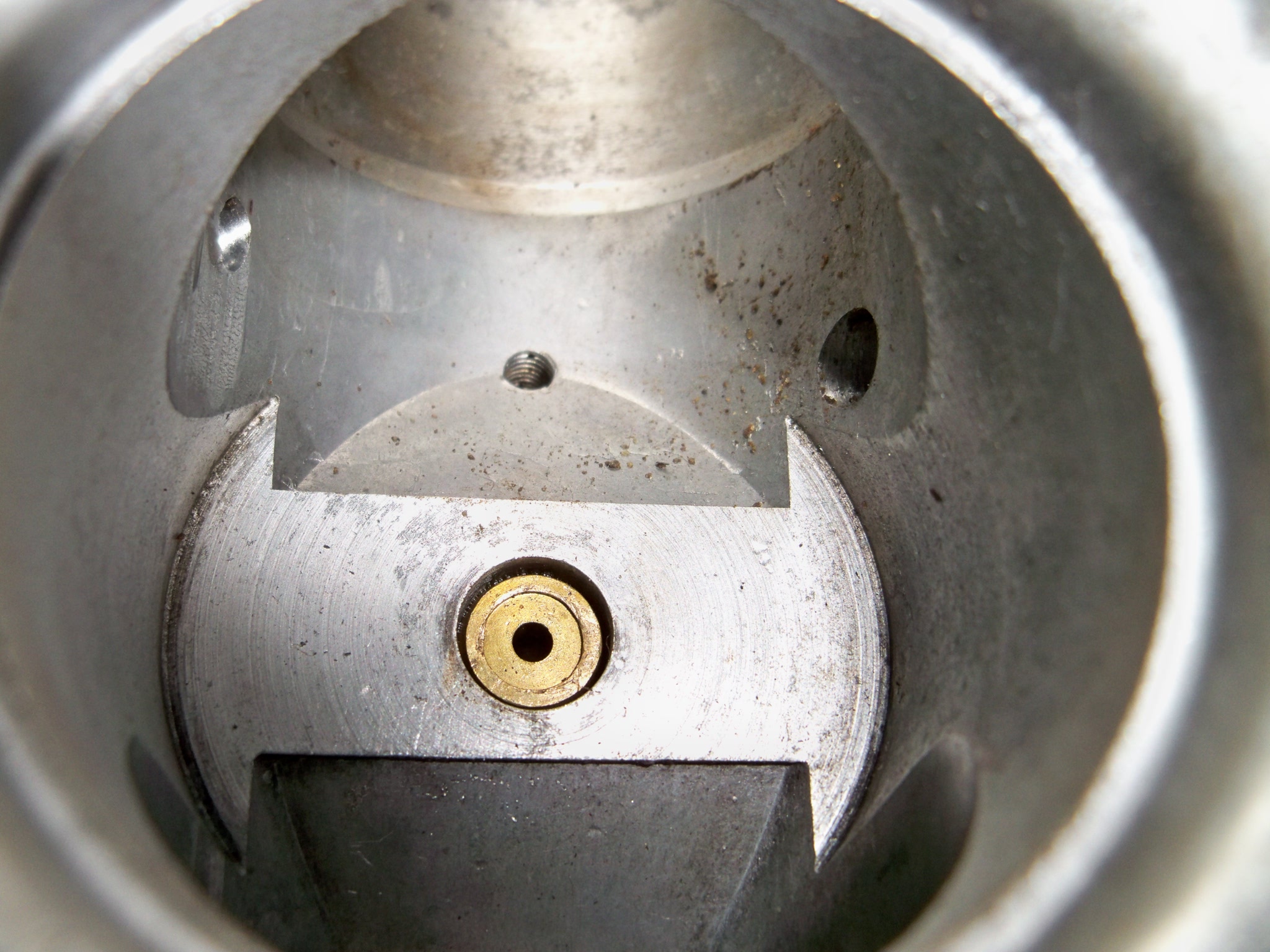

And when you put the jet back in..remember it sets the richness of the mixture, so if you were happy with the mixture, make sure you get it back in the identical depth from the bridge.
