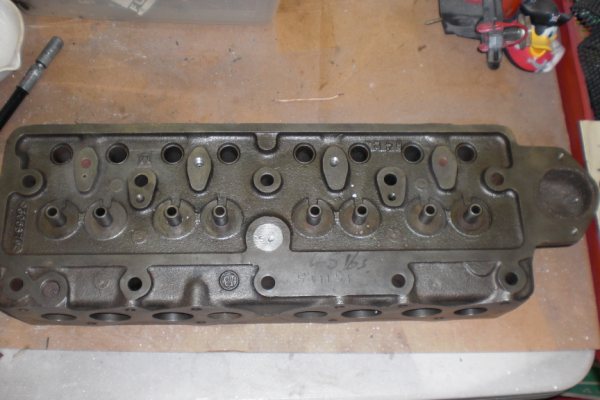

Anyone here have any experience will putting a Standard Vanguard cylinder head on their Triumph? I have found a low port Vanguard head that fits on a tr2 or tr3. There is a small modification that needs to be made. The head bolts on a Vanguard are 7/16 and not ½ inch like the Triumph, and the exhaust ports are round and not rectangular like a Triumh, but that is supposed not to be a problem. Other than that my understanding is you cannot tell the difference when everything is hooked up on the engine.

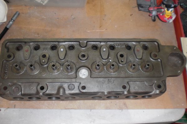

Here is a picture of the Vanguard head. I wanted to put this head on a tr3 engine, but I am not sure of the effect the head would have on performance. I do not mind a small lack of power the setup would have, my main concern would be the fouling out of spark plugs. I have a set of H4 carbs for it. Anyways perhaps someone would know if a low compression head would create a problem in general.

Thanks for chiming in John, I did check with Marv and his comment was long gone on the tr2 heads. The one I found is in UK and it is the Vanguard motor. I posted some stuff on the UK forum and the guys where kinda helpful, but one guy said I need a Triumph specialist because his concerns are the complexity of combustion chambers. I do not mind a little less power; I want to make sure the fuel burns.

The cost of getting a cylinder head out of UK is probably way too expensive. The guy I am talking to over their wants a commitment before he does more research. I will keep looking for the tr2 head for a while. However, part of me thinks the Vanguard head would work fine once the bolt holes are made larger from 7/16 to ½.

I don't think anything combustion chamber related will be an issue for you. The pistons are flat, so they do not need to match a particular chamber shape, like many performance set-ups. At most they may have a slightly lower compression ratio...but I would even doubt that, as the TR2/3 were relatively low, at 8 to 1 anyway.
I'll look through my old pictures and see if I have any of the TR2 head pics that might help you decide if the Vanguard is close enough.
