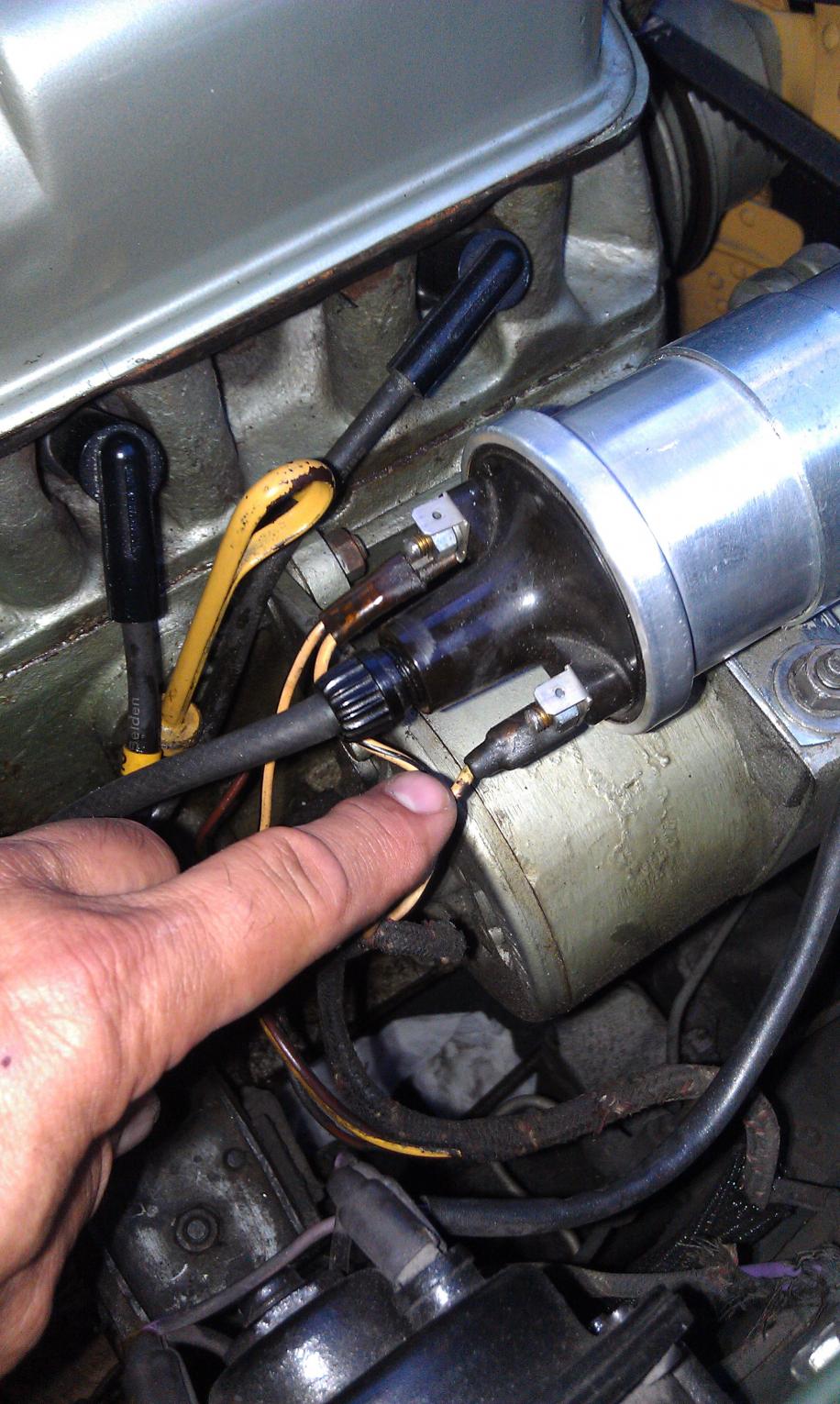

Talk about luck! I found out the cause of my stalling, purely by accident. When I ponder all the possibilities of what could be the problem, I will start doing a little detailing in the engine compartment as a way of starting the trouble shooting process. And starting with the ignition coil, I was attempting to clean up the wiring's color coding and connections when I realized a flimsy feeling at one of the female connectors to the coil. Using the remote starter switch and pressing against the negative lead to the coil, the car started right up. Gently tugging the lead away from the coil but still very much connected, the car stalled out. Lucky because the break in the wire is completely concealed due to the rubberized coating around the connector. I will try to post a picture of the little culprit soon. Thanks Larry for your input as well.
There's the little bugger that (hopefully) is the cause of my problems...

Glad you found the problem; intermittant electrical ones are the worst! But reflecting on the rotor tang breaking makes me wonder about the overall condition of your distributor. Next time you have the cap off, feel how much free play is on the shaft; side to side movement could represent worn bushes, and up & down ("telscoping" if you will) could be as simple as the screw under the rotor being loose.

Thanks. Cap and distributor cam nice and snug. I always keep an eye on the distributor and now and then oil as where indicated, though maybe more can be offered on maintenance. Any further suggestions?? But for now, no play. Same with my previous Healey I had (crushed by Sandy). I hear this is a common problem. Looked at my replacement today. Holding up very nice. How long, who knows. Drove her for a little bit today. That little swine/bugger of a connector fixed. Should be no more issues there either, ya think?!
