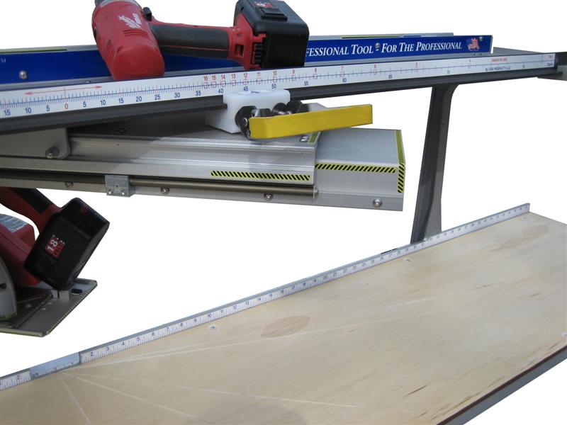

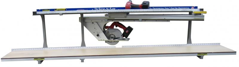

Example is on this tool I designed built and patented.

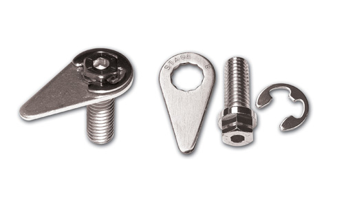

these are hex head bolts with an Allen head incorporated inside the hex head. There are certain applications like the heater, MC box, heater valve, etc. that I thought might benefit from using these.
Rut
I hadn't heard of these until your post. They sound interesting. It looks like they have found common use where locking fasteners with indicators is of interest . I found lots of pictures showing them used on exhaust flanges and headers.

I've used the stage 8 bolts before... They work good for header bolts, just don't forget to loosen the inner locking bolt before loosening the outer bolt... If it's an aluminum head, you'll have a bad day, ask me how I know. Tore the threads all to ****
