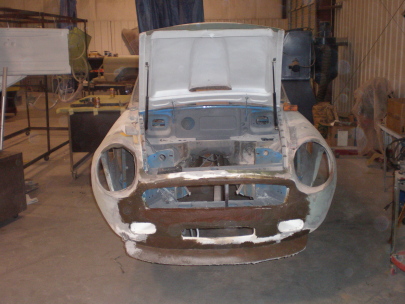

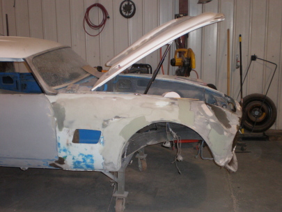

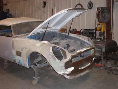

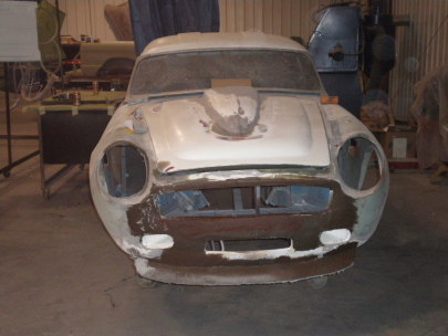

Bodyshop is slowly moving along...reshaping of the nose is progressing & the hood is hinged & operational...a few minor adjustments & we'll start installing/modifying the latch mechanism.
Oh, the dark stuff below the grille opening is fiberglass where we've started reshaping the opening & where we moved the lower grille area and valance forward to be flush with the upper grille area.

Tony...let me know how those struts work with the fiberglass bonnet. Thanks.
Will do, Rick...I ordered them from McMaster-Carr....was a little worried until I tried them a couple of times today...they don't start working until the hood is raised about 4" then they go up quickly but smoothly.....but we weighed the hood & fitted them to that weight.
