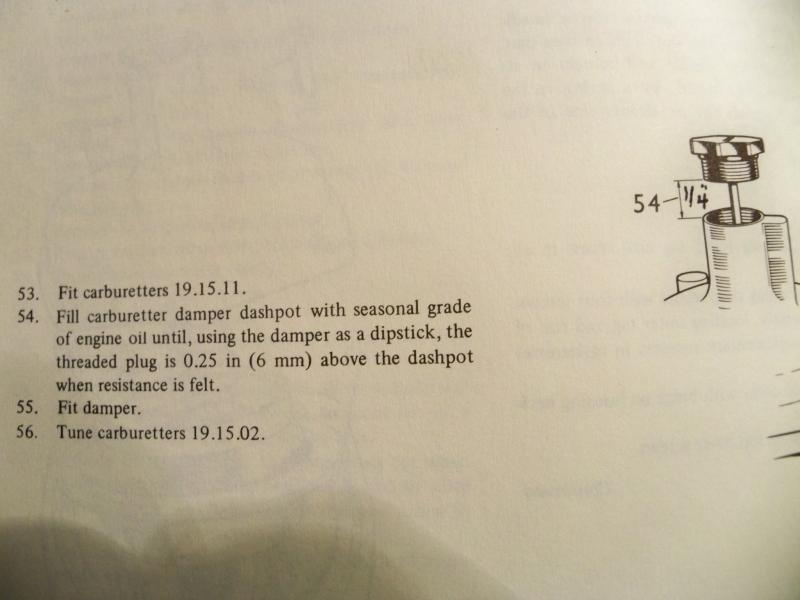

One other item - oil is not remaining in the dashpot. When I add oil up to the top ring, the oil will be gone within a couple days.
poolboy
Whatever the problem, raising the needle to maximum height is really just an attemt to compensate for an underlying problem.
I'd put the needle in the middle of it's adjustment range and try to find the actual problem.....1 and 1/2 CounterClockWise from Fully ClockWise.
I've never been able to get satifactory results with a UNiSYN type of synchronizer on ZS carbs...It blocks some ports in the carbs' air box mounting flange.
And while I see your point about the damper oil level, I'm not sure you are filling just the damper well properly when you refer to the 'top ring'
See this: ZS carb Damper level 002.jpg

And...carefully just put the oil in the damper well; it's the smaller diameter cylinder that you see when you unscrew the damper knob/piston
The Owners Manual recommends using the same oil and viscosity that you put in the TR6's engine.
