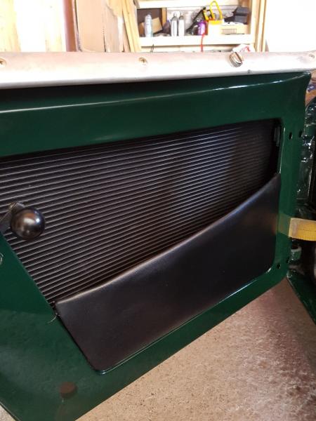

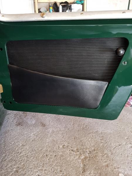

Finally got it done this past week. Here it is! Looks decent but will have to see if it holds up over time. I ended up using Lepage heavy duty contact cement. Can't find anything better locally. I folded up the mat in half up/down. Applied contact cement on the top half of the mat and top half of the door. I put 2 pieces (1 wasn't wide enough) of wax-paper folded in half with the fold line on the top edge. After getting the mat in place, I pulled the wax-paper down and out. With the top half secured, lift the mat up to reveal the bottom halves, put contact cement on the mat and door, wait for it to dry then push it down..
