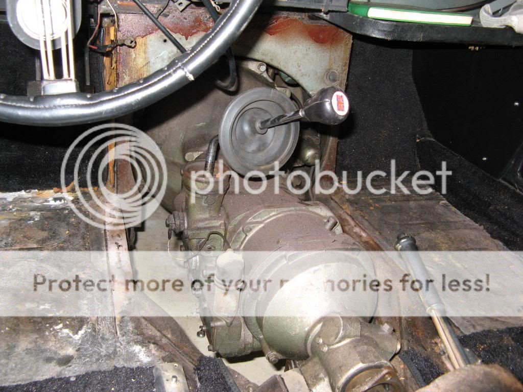

If you can get the side cover off, you could fix the spring and pin for next to nothing. Just remove the cotter pin and withdraw the pin and spring and check for problems. Order new parts. The pin must be sticking when depressed. Could be a weak spring or a corroded pin.
Here is a pic of the trans in place with tunnel off showing the room you have to remove the side cover. You'd need a new gasket.
