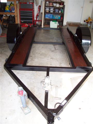

Here is my trailer - found on Craigslist fairly inexpensively because it is so small(and ugly). This pic shows my new GT on it. I actually had to move the inner edge of the wheel ramps inward so that my midget didnt fall between the ramps! Trailers this small seem to have limited appeal and therefore sell for less.
