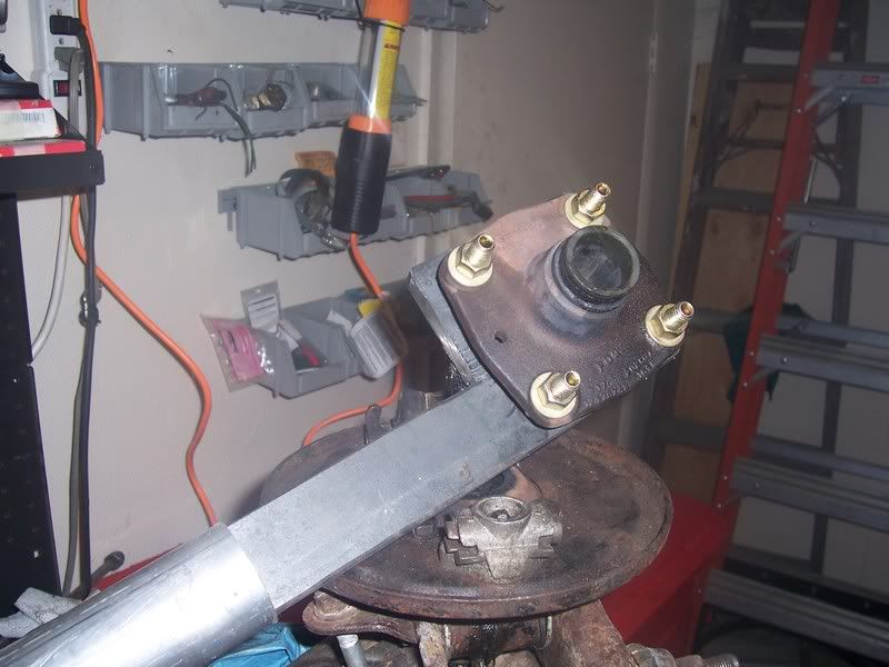

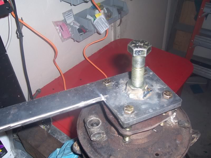

Eh, only reached DEFCON 2... Made my own puller out of 3/8" flat stock and a 3/4" grade 8 bolt. Reefed on it with a couple of pipes, gave it a couple whacks with the BFH and the thing came shooting off! /bcforum/images/%%GRAEMLIN_URL%%/smile.gif Yeehaw!

I don't think so... Ever see what BV wants for one? $290!!! Anywhoo, I built a plate so I could use the same puller to press the axle out of the bearings. Pretty slick. I got the whole thing completely ripped apart tonight. Now to buy stuff... Oh yeah, the thing jumped like 6"!
What can I say.... brilliant.
I would fuss with it a bit, and maybe put a round collar-spacer under the plate to support the face of the flange more, but, hey....its still brilliant.
I like the fact that you can hold it away from you with that 'handle'. When those hubs pop off you don't want to be standing in front of them.
<div class="ubbcode-block"><div class="ubbcode-header">Quote:]I would fuss with it a bit, and maybe put a round collar-spacer under the plate to support the face of the flange more, but, hey....its still brilliant. [/QUOTE]

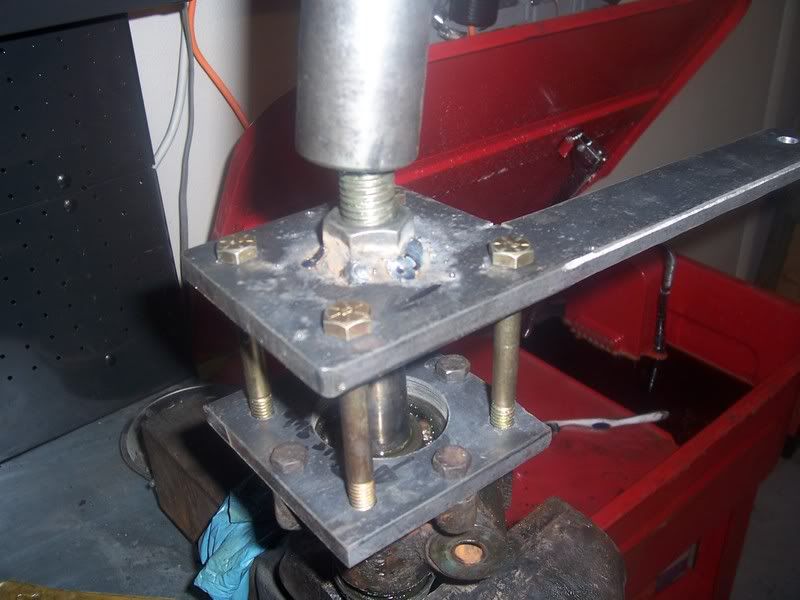

I thought of that. Only round stock I have right now is 1-3/4" and 1-5/8" DOM. Other than that it's exhaust tubing. The plate was bolted up against the center of the hub though. Thanx! Here's the plate for pressing out the axle and the finished results on the bench;
