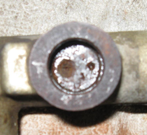

This is what I see when I look under the resevoir. Nowhere to put an allen wrench. I'm starting to wonder if the car has the correct master cylinder.
different than the one for my 73.. I have ears on each side of the fill ports to bolt the resevoir on..will get you a pic tomorro..

I can't recognize what I see in the picture above. What year Spit are you working on Jody? Is it a single line brake system or dual?
It's a '78 Spitfire 1500. The photo is of the resevoir mounting point where the tip valve should be. This is why I'm starting to wonder if it's the correct MC. I tried googling the Girling # but got no hits.
Jody
Jody,
Your master has the pin on reservoir, right. On the heritage cd it shows a pin in the rear brake fill port that may be holding you up.
I have the earlier tandem cylinder on the 73. It has a the tipping valve in it. Must have been a change when the resevoir changed.

Yes, there appears to be a pin sticking up slightly on the second fill port. I'll see if I get get it pulled out.

The photo's of the fill area, not the bore. I've not seen inside the bore yet as I've not been able to get the guts out.

Found the pin, I had to drill it out until it would spin free. It's out now, but when applying pressure from my air compressor the inner guts will still not come free. I've filled the inner workings with penetrating oil to see if that'll help free it.
