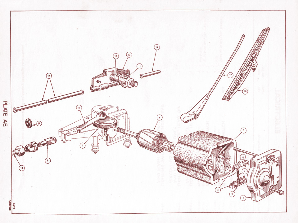

My bad earlier. In looking at the Spare Parts Catalogue, it appears the cable end simply slips over a post on a rod that is fastened to the gear assembly. Once the cover is off, the cable end should lift right off that rod, although there might be a small "c" clip or similar?
If it's the same as the TR wiper motor (DR3A), there is a clip to remove and then a link to lift away. That frees the inner cable, then the outer cable just pulls up out of a slot.
The link is item 8 in this illustration, the clip is at the top of the post on the gear.
Yeah, there are a couple of other components there that are not shown either, like the brass "finger" that forms half of the park switch. ISTR there might be a flat washer involved as well.

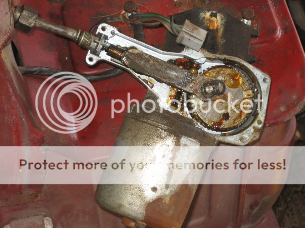

This is what it looks like in real life.
That's the later wiper motor, not the one shown in the SPC or on Canley Classic's website for Joe's Spitfire 4 (aka Mk 1). But it still comes apart the same way.
Or as Roger says, you can pull the rack out leaving it attached to the motor if you want. Makes kind of a mess IMO, the rack will be covered in old black grease that will mark whatever it touches and it's hard to control the rack & motor at the same time. But it will work. You'll probably also have to pull the arms off the spindles to get it all timed properly once it's back together.

The Canley Classics drawings are a big help for a visual person like me.
