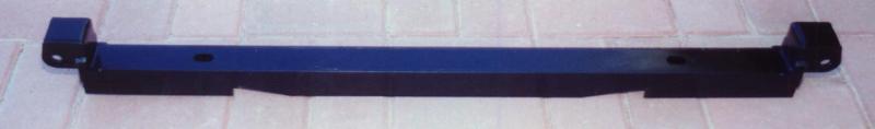

Fortunately, there is (was, but hopefully still is) another option, thanks to Joe Curry. Check this out:
https://spitlist.info/Shock.Mounts.htm
Thanks Andy, that was something like I had in mind and have already talked to the owner and we are going that way. Kind of a no brainer.

We need to call the shock mount store today, Joe Curry, but the site doesn't seem to be active. Will try the phone and hope he has one left. I could do one, just hate to spend the time, when that one would be perfect.

Andy, What Now Coach? Joe's phone listed on the site is not any good. Any idea who else may be making these?

I will cut all the shock mounts and trailing arm mounts off the body after taking some measurements in case I have to make a shock mount. I do wonder why Joe didn't make it so it also bolted through the original shock mount, just a little extra support in that area.

All, Joe no longer makes these parts as he was losing money on them. Not acceptable in any way for that much effort. He was kind enough to send the blue prints for making the street version and no one could have been nicer. A big THANKS to Joe. Now to find a shop to make it, he did stress laser cut only on 3/16 sheet metal.
