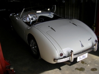

How about rear taillights from a Healey BN1 or BN2? they are similar in diameter to a Sprite lamp, but do not stick out so much.
