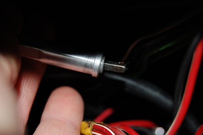

Finally got the speedometer to stop jumping. To quickly recap: speedo was working fine, ordered a new cable because the old one had paint overspray on it under the hood. With the new cable, the needle was jumping badly, worse at lower speeds. I ordered a spray moly lube, and sprayed down the cable. Still jumping. Removed the cable and sprayed on more lube. Still jumping. Removed the cable and lubricated with white lithium. Still jumping. Removed, greased and replaced two more times. Still jumping. I then compared the new cable end at the speedometer with the old and noticed that the nylon piece attached to the cable was sticking out about 1/16 on the new, and not at all on the old. I loosened the nut a couple of turns and no more jumping! I then removed the cable and used a fine hacksaw blade to shorten the nylon piece. Reassembled it, and the jumping is gone. I have attached pictures of the before, after, and the old cable. I will contact the vendor and let them know.

I installed a new Moss cable and it worked great for about 20 miles then the spedo stuck at 38 MPH. After some more driving I heard a squealing noise so I unscrewed the cable while rolling and the spedo started working. I may have the same issue with the plastic sleeve, I will look at it tonight.

The cable protruded about 3/8" on the speedo end, controlled by the plastic part.

When I sent my TR3 speedometer to MOMA restoration service in Albuquerque to have it cleaned and repaired, they requested that I include the cable I intended to use, which indeed they modified. As I recall the ends of the cables commonly available were all slightly too long.
Similar to Perry.
The gent that restored/recalibrated my Speedo had me send the cable which he gutted (housing) and replaced with a new correct length/diameter inner cable. He always recommends this and told me that proper resistance is as important as free moving and the lengths of many on the market (tip from the ferrule) are too long.
Works perfectly, almost looks like it's electric.
I sent mine to West Valley Instruments and in my conversation with Morris he asked me to check how far the inner tip protruded past the housing. I wish I could remember the length but mine was about 1/16" too long. He'll only guarantee the repair work if the cable tip is the correct length. If it's too long it can cause internal damage over time and/or erratic operation. I included my cable with the speedo and he made a new inner cable and returned the old one. I'm sure this carries over to the tach as my tach makes a ticking sound. If I loosen the cable "nut" so that I can pull the tip of the cable back, the ticking stops.
The moral is......if the shop you're thinking of using doesn't ask about the cable.....find another shop! :driving:
