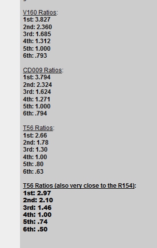

Below link to a good discussion. The Nissan evidently will handle more horsepower and has a built-in bell housing. Wonder where the shift lever falls. Supra W58 good for only 300 hp. Tremac T56 can have very low numeric top gears.
https://www.suprastore.com/howmupocan6s.html
Tremac kit is also available for Healeys from Oz. Maybe Healey Factory.
CD009 evidently has a 1.000 5th and .794 6th - not as good as the .783 of the Supra W58
