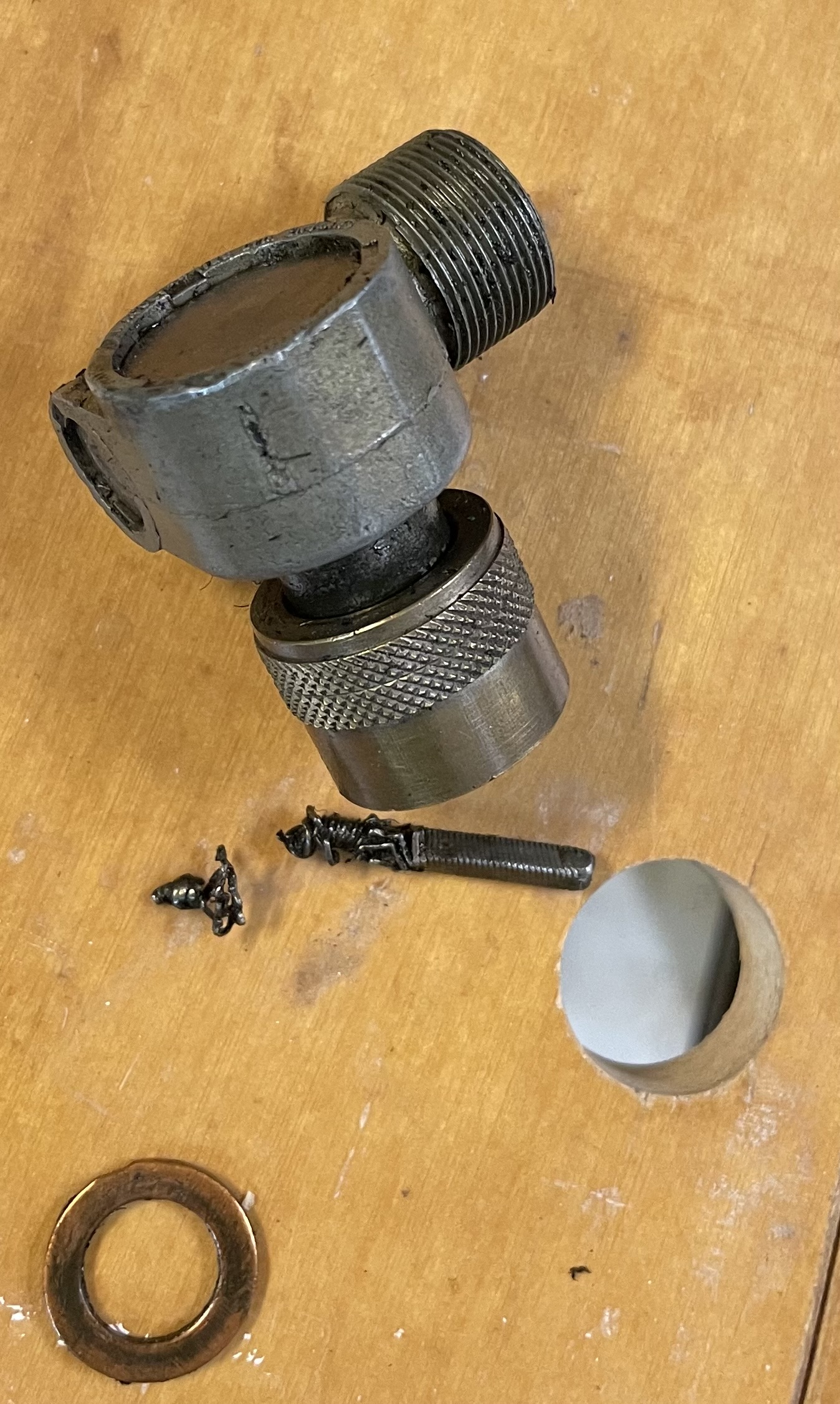

Well, as you can see, the copper washer didn’t exactly save my angle drive. Snapped and twisted right off. What’s the deal with these?

The angle drive broke; that’s the mating shaft on of the angle drive you’re seeing—snapped.
Interesting. Mine failed similarly, but differently. Instead of the mating shaft breaking, it simply "spun" inside the shaft. I fixed it with solder; I suppose you could do the same thing, but perhaps there is too much resistance in your speedometer?? In this thread, https://www.britishcarforum.com/community/threads/o-d-right-angle-drive-choices.128749/#post-1218867, Bob mentions he had a broken gear in the odometer.
Again, grasping at straws... there is always the twice as expensive version from Rimmers??
I just took my new one apart. It’s so simple and cheap. Even the snap rings don’t have grooves, just a machined seat to hold them in. Now I wish I did order a different one. And I’m not buying that copper washer “fix” advisory. My copper washer did nothing. It’s either quality or it’s not.

Happened to me as well once. It was the cable. Too much resistance for the weak angle drive to spin the cable.
You can also remove the cable completely, douse it out with some lube spray, get it nice and clean and oil it upon reassembly. Be sure not to have too many tight bends in the cable as well.
