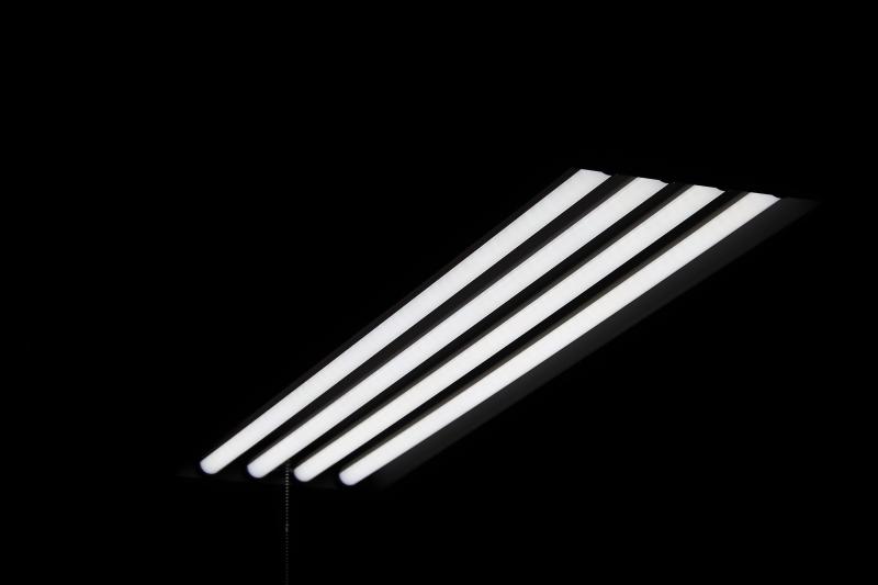

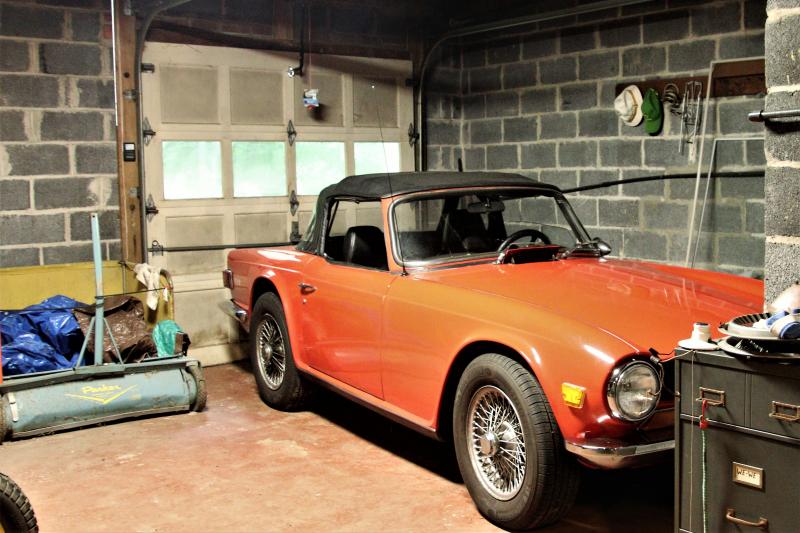

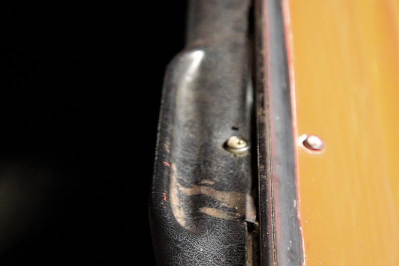

My '71 TR6 did not have door pulls and the panel was pulling away from the door so I drilled a small hole in the top and installed a screw and trim washer to hold the panel when I pulled the door shut. I also (finally) had an electric motor installed on the cellar door and installed a 4-bulb LED fixture to replace the 2 lamp fluorescent that took 5 tries to get it to light. My back was not allowing me to pull open the cellar Cellar LEDs.jpgTR6 panel screw.jpgdoor.
