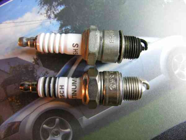

In photos I have seen of the Bosch Platinum-4, they look like they have too much reach for the TR3? Have you found this to be a problem? Also, what is the heat range as compared to the Champion L87YC provided by Moss -- hotter, cooler, or about the same?
I am running Bosch Platinum Plus 4032 shown next to a used NGK BP6HS. hth. Pete

PeterK,
Many thanks. I'll do some research on them.
Edit: I looked up the Bosch Platinum Plus 4032 and found that it is a WR7BP, which indicates that it is a 12mm plug. I was under the impression that the 58 TR3 takes a 14mm plug. Am I missing something here?
