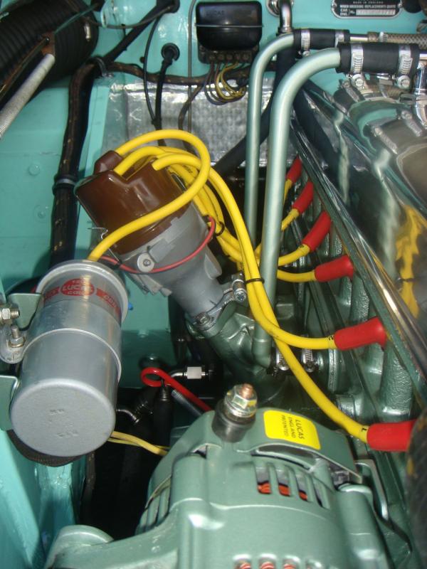

I'm using a Pertronix ignitor, Pertronix top entry brass distributor cap, (Moss) premium Ignition rotor (red), Lucas Sports coil and Champion RN12YC spark plugs.
What brand and mm spark plug wires are people using or recommended for this set up?
What timing degree would be recommended?
Thank you.
The stock, stranded copper wires are, I believe, 7mm but most modern suppression wires are 8mm IIRC. I'm guessing a modern cap will use 8mm.
I'd stick with the recommended 15deg BTDC@ 600RPM with the advance disconnected and plugged, or 35deg total at over 3K RPM (if you have an advance meter).
The Pertronix top entry brass distributor cap I have I'm using 7mm Pertronix wires. I believe it will take 7mm or 8mm?
I was using copper wire but it affected the tach. With
Pertronix wires, tach works properly.
I question if I should use 8mm wires being I have the Lucas Sports coil and Pertronix ignitor.
Call Pertronix; in the past, at least, they have been helpful. Note Pertronix specifies an impedance min/max, so you might want to verify a Lucas Sports Coil meets their specs (I suspect you won't be the first person to ask).
Will do. Read posts where Lucas coil and Pertronix ignitor are used. Haven't read about which spark plug wires in mm or brand.

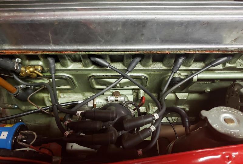

I'm using Pertronix 7mm Stealth wires with my top-entry 22D distributor & Pertronix II ignitor. They make these plain black sets for those who want a period look without the bling. I gave up on the straight boots as I kept pulling the wires out of the terminals.
IMO the Lucas sports coil is fine with the Pertronix. Pertonix doesn't recommend copper wires anymore, although everyone says they work fine with Pertronix I but not with advance timing lights.
Some British racers had Pertronix failures due to imperfect grounds through the various joints in the distributors. I ran a separate ground wire from the Pertronix mounting plate to the chassis at the coil mount. Belt-and-suspenders.

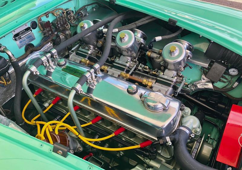

Dougie - what is the black pipe going rearward from the upper radiator hose?
I thought you would pick-up on this quicker, here's my responces to Linwood's PM right after my post.
HAHA.....I wondered how long it would take and who would respond on this. So what we've found through many race hours and dyno testing, the rear cylinders don't get
enough cooling/water flow and always runs much hotter then the rest. (back to the poor head design) Solutions is to increse flow.
1f609
1f609
Thank you for the answer. Very interesting. Could do without the snark, though.
