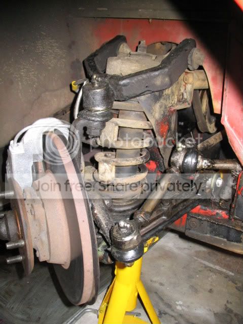

Any ideas on what is up with this spacer on the front spring? Both sides have one...
Someone felt the front end was a little low, and added those to raise the ride height.

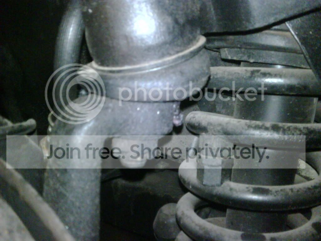

Funny, my passenger side had two! Here's a pic from 4 years(!) ago...
Pulled them off, measured both springs and they were equal, so off they remained!

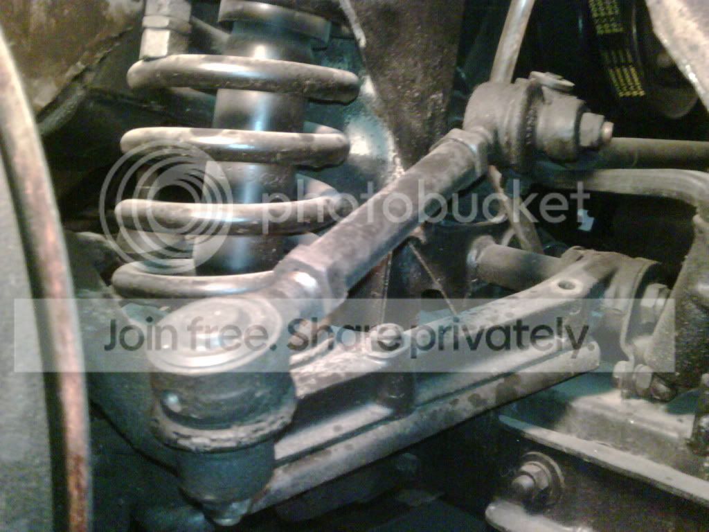

I've got bigger issues to deal with on her, so any harm in just leaving them for now?
Nah, I don't think so. Some claim that they can weaken the springs further (by putting more stress on the remaining free coils), but I doubt it makes enough difference to matter.
