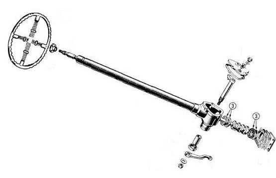

TR2/3/3A source for TR2-3 steering bearings?
eschneider
(TR2/3 long shaft steering box)
Moss 129-108 NLA...
not seeing in TRF catalog?
Vicky Brit - nope.
Bearing warehouse boffin laughed at me.....
Anybody seen a source for these?

The 'real' TRF TR2-3 catalog is the factory parts catalog, which you can download from here
