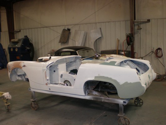

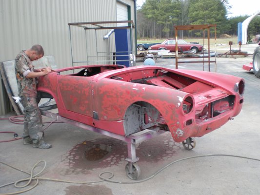

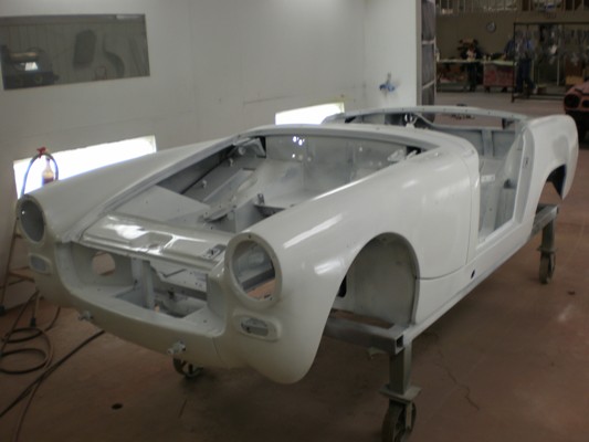

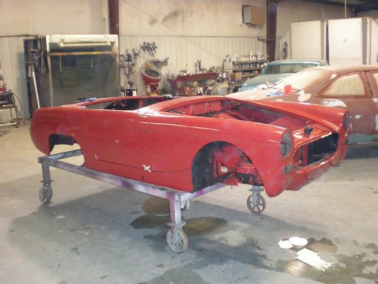

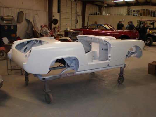

Here's the sequence we're following on my '63 Midget - a little different than I usually do a car. This car had only been painted once after some accident repairs & was solid so I decided not to srip it to bare metal or to completely disassemble the tub.
1) First photo is the tub as we started.
2) Second photo is as we took the 2nd coat of paint off to identify the previous repairs & evaluate the original factory work.
3) Tub completely covered with 2-part epoxy primer.
4) Body work being done. We removed all the previous bodywork which was very good & redid everything to our standards.
- the entire car was wiped down with foamy glass cleaner to cut any grease or body oils from it. Then,
5) A second coat of epoxy primer was put on all the repairs.
Next (not shown in photos, they'l come later) we'll spray a red sandable primer on the body - photos Thursday. Sanding that coat will reveal any minor bodywork that still needs to be done.
Then, we're wipe the car down again with window cleaner & reprime it. The final sanding should give us a straight tub (if not, we'll continue working on it to achieve that).
We don't spray a sealing primer. What we do is spray 1 coat of body color & let it 'tack off' for about 15 minutes. It then becomes our sealer over which we'll spray the remainder of the color.
Then we'll sand the finished cars & spray the clear coats.
Here are those first photos:
