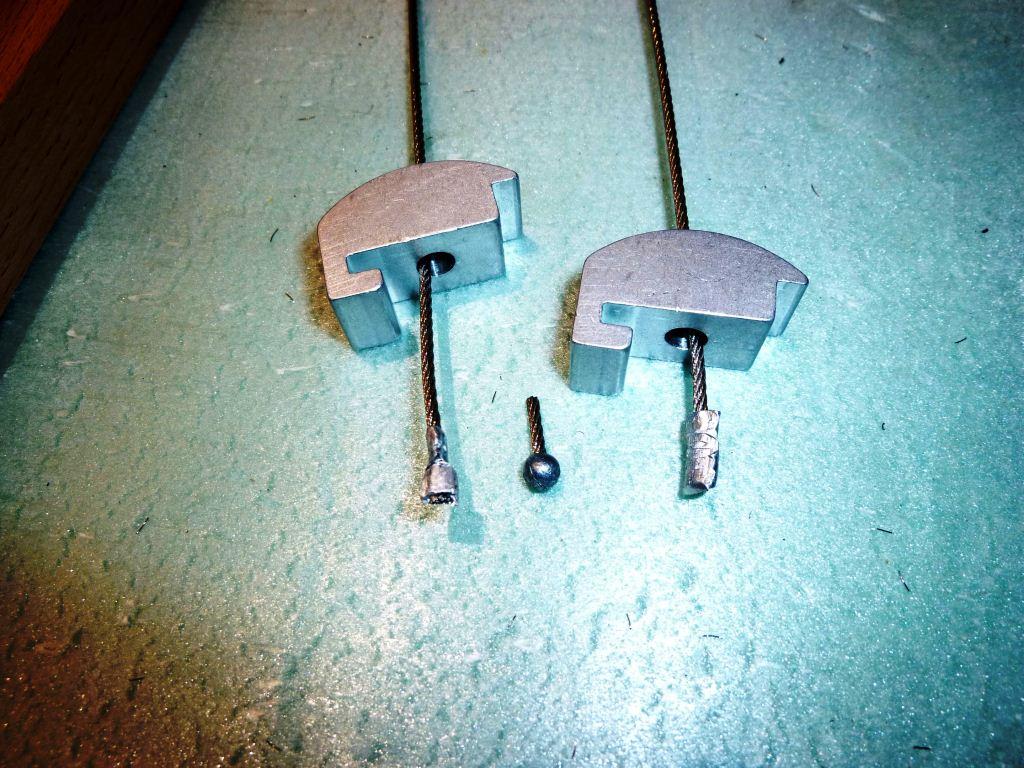

Ok, I couldn't find "real" Nico sleeves but I found pop rivets which had an internal diameter close to my wire, so I am taking them apart to use for sleeves.

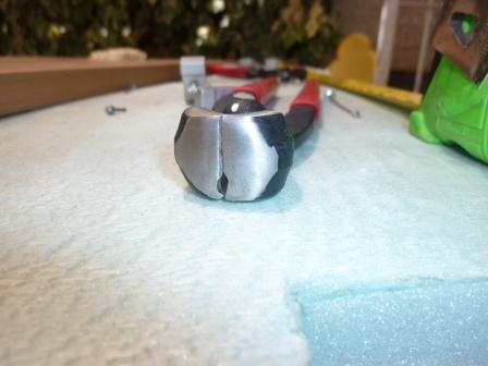

I also bought a cheapy pliers which I ground off the edge and added a small rounded recess to make a swagger tool.
Since I couldn't pull it of I hope it will be strong enough!
And the swage
Not sure why this picture doesn't show up but it works when you click on it.
70herald said:
And the swage
The picture is 180kb. If a picture is less than 150kb it will show "inline" but if it is bigger (in file size) it shoes as an attachment.
