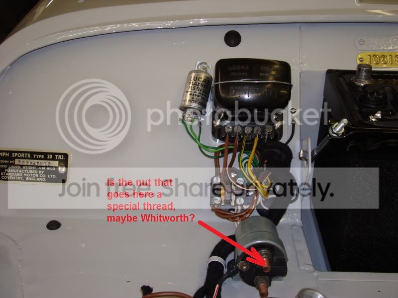

TR3driver said:They are definitely a special thread (and width) on my TRs, although I don't recall what offhand. I kind of think maybe 0 BA, but might be 1/4 BSF instead. I can check in a few hours, if no one else knows.
Once you come up with the size, you can probably find a suitable substitute at https://www.britishfasteners.com/mm5/merchant.mvc
But I'm guessing they won't look exactly like the originals (which are thinner than standard nuts).
My solution was to find an original solenoid and rob the nuts from it. Eg,
https://cgi.ebay.com/ebaymotors/TR3-TRIUM...sQ5fAccessories
yes, or copper platedangelfj said:TR3driver said:They are definitely a special thread (and width) on my TRs, although I don't recall what offhand. I kind of think maybe 0 BA, but might be 1/4 BSF instead. I can check in a few hours, if no one else knows.
That's a good idea. thanks, Randall!
Just curious, Randall: does what you say hold true for both styles of solenoid? There was a change around 1959-60 from a solenoid with integral mounts to one with a separate mounting "ring" (like most coils have). I took a quick glance at my later-style solenoid just now, but I couldn't tell by looking what the threads are. :wink:TR3driver said:They are definitely a special thread (and width) on my TRs, although I don't recall what offhand. I kind of think maybe 0 BA, but might be 1/4 BSF instead. I can check in a few hours, if no one else knows.
