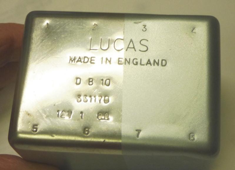

I soaked my rusty flasher relay cover in white vinegar for a week - with several vinegar changes - no buffing, merely polishing with paste to remove the oxide haze.
I painted the right side of the cleaned-up cover with Eastwood's clear zinc paint to see how it looked next to the original plating:
