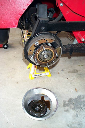

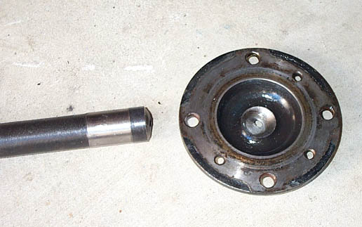

Snapped an axle
Is the housing or hub bent near the wheel? That would stress the axle on every rotation. Insert the new axle with no o-ring or gasket and check to see if the is a gap anywhere when you hold the axle in by hand. If the housing or hub is bent you will have one area that is touching that gets progressively larger to the point that is 180 degrees away from the point that they touch. If you keep looking as you continue around the gap will decrees until you get to the point of contact. Do not rotate the axle when performing this check and do not use the fasteners during this check it will bend the parts closing the gap.
After the break, I replaced my axles with a pair designated BTA806S. They're supposedly one of the later, stronger types, and the guy I bought them from gets the splines hardened. So far no further problems, but it's possible that's because the car has been in the garage several months with clutch problems.
My understanding is that Bugeye axles usually break near the hub; they're even weaker there than at the splines. As for that junky replacement axle, it was probably just the luck of the draw that it broke where it did. It was sure to break somewhere.
I think the break at the flange is more rare. The twisted splines usually start a little at a time. It is a good idea to take them out every so often and check them. The racer guys do it all the time. My BE when I got it had one good axle and one with the spline just ever-so twisted. What every you do, do not switch them side to side, thinking that will untwist them! All that does is accelerate the fracture. Bought two ( from a 74) so now I have a spare.

In my experience, street cars break more axles at the inner (spline) end. And racers tend to break them at the outer (hub) end). This is not 100% true.....but more generally.
I used to break them at the spline end when I was autocrossing. All the sudden starts did it.
On the other hand, road racing tends to have less sudden starts but flexs the outer part of the axle during hard cornering (especially with single-bearing hubs and sticky tires).
I broke about two or three a year at the outer hub end until I switched to double-bearing hubs (which reduces the flex on the axles....these axles are semi-floating). I only did that a few years ago.
The double-bearing hubs are almost $500 and used axles can be gotten for $10 :wink:
As stated, it's real important that the entire differential/axle housing be straight. I bend one (slightly) in a race accident a few years ago and I snapped two more axles that weekend. To be honest, it's hard to find a really, really straight one!
