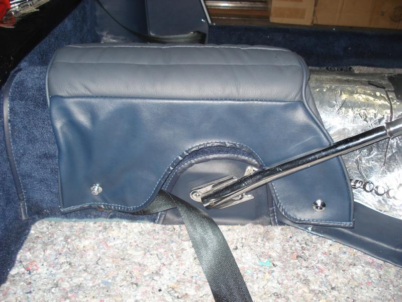

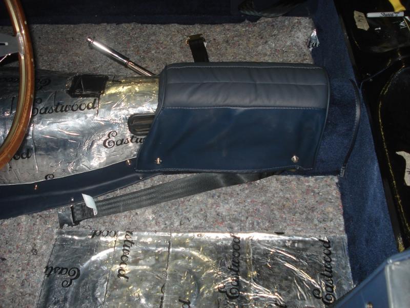

Hi all,
My BN6 is an early one (#613) and according to the information on Healey6.net I'm supposed to have the "snap on" armrest (saddlebag). See quote below.
Does anyone have one of these installed on their BN4 or BN6 and can tell me what type of snaps and where are they located? Pictures would be much appreciated...

Heres a couple from a BN4
