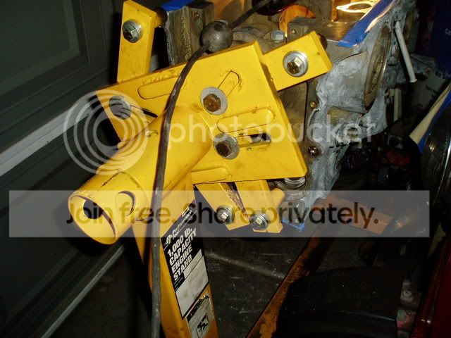

I have an old homemade stand. It requires 4 inch long bolts. And no matter what, I could only get in 3. So I have a TR3A engine hanging off a homeade stand with just 3 5/16ths bolts holding it on...
It's been that way for three months, no problems. Still makes me nervous sometimes.
I just took mine off of the stand yesterday! I attached it to the backplate and grabbed 3 of the 3/8" holes and 1 of the 5/16" holes. That gave me nice distribution and balance. I also used washers on both sides. Keep the motor suspended from your crane, attach it to the stand and slowly take the weight off of the crane. When you're satisfied that the stand has the weight and the engine is balanced, remove it from the crane.

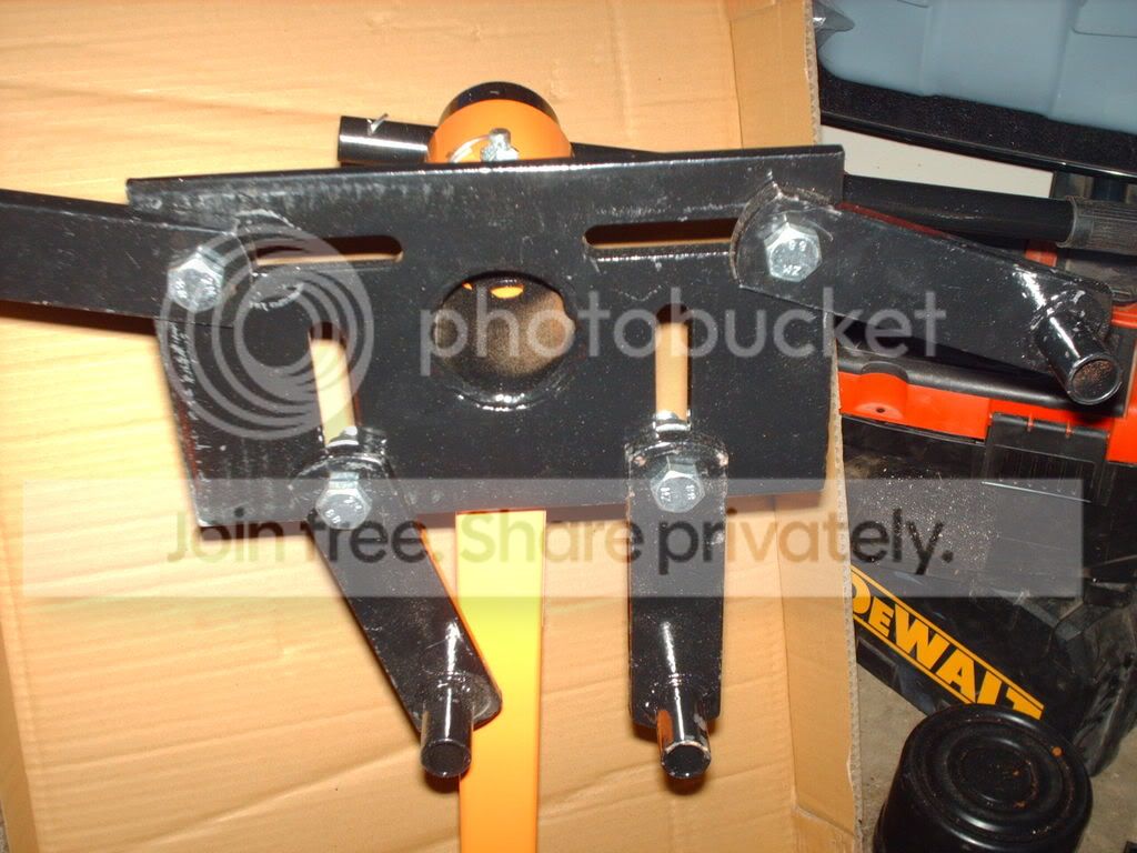

I have the "same" stand and what I did was build an interface plate between the engine and the stand. That way I could use ALL the bolt holes that the tranny mounts to the engine with to attach the plate to the engine and then I could use bigger bolts to attach the plate to the stand. You can see a picture of it at: https://ca.geocities.com/adrio@rogers.com/Tr4/tr4pics/enginepaintl.jpg
