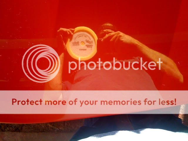

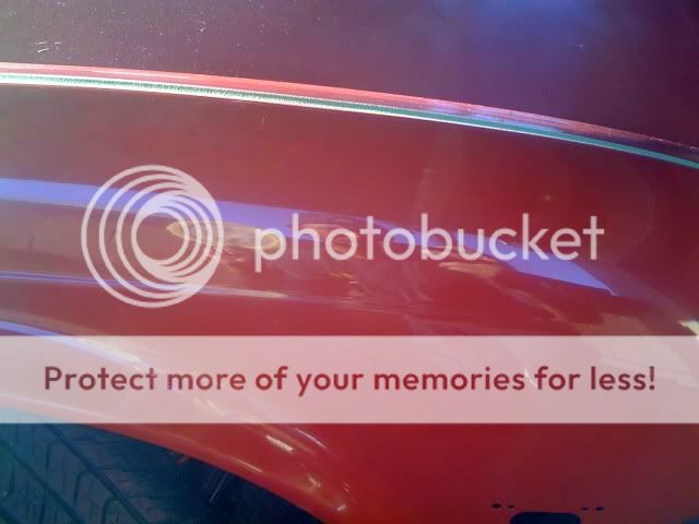

I started buffing the paint today and buffed one fender and part of the hood. Now my shoulders are sore, and after a couple of refreshments I lost motivation for today! :cheers:
how are you buffing? By hand? get some foam pads and a DA and you will be done in an Hour, I got my pads from Autogeek, check them out

I sanded with 1200, 1500, then 2000 and now buffing with a medium cut wool pad with 3m perfect it 2 compound. I'm going easy with it to keep from burning through the 3 coats of paint.
Are you finishing off with a glazing compound or stopping with Perfect-It?
I found that after a good going over with Perfect-It, washing and rinsing the surface, then changing to 3M glazing compound on a fresh foam pad made quick work of the process. After a quick going over with the glazing compound, wipe the surface down with a micro-fiber towel and the gloss will just pop at you.

In the shop we nib off with 1000, then hit it with 1500 on the DA (lightly ) This is followed by 3000 wet on the DA(no 1500 scratches are left) Now it buffs easily with a wool pad and 3M perfect it #1.The final polish is #2 with a foam pad. If you do it differently than this ,I wish you luck,you will need it....There is no better/faster way in my experience(40+years).
