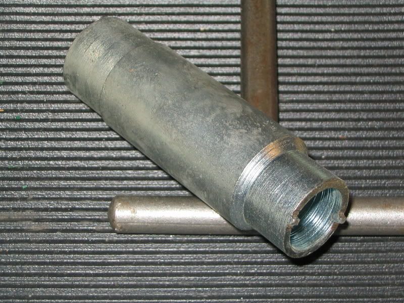

Master Mechanic Bugeye58 has made me a tool to try, which he's sending along for trials! Another reason why BCF is *the* forum of choice for all LBC fans.

Glad it worked for you, Julian. I took the length of the control shafts and switch toggles into consideration when I made it. I was a bit concerned about the ID, as I didn't have a switch handy to test it on.
No plans to go into production, though.
