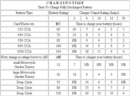

Johnny said:Good day Olin, and all. Not to throw a wrench into things(sorry, no pun intended)but you have to be careful not to buy too large a battery. Unless you've changed out the generator to an alternator you may no longer have the capacity to keep the larger battery fully charged and it will eventually run down. Think of it as a water faucet filling a bucket vs filling a lake.![]()
Sorry, but this makes no sense (I'm not an EE, but have some electrical knowledge). This statement seems to imply that car batteries--AGM or regular lead-acid--are in a perpetual state of discharge and that a higher-capacity battery will discharge more. This is not the case.
The demand on the battery--called the "load"--is the sum of all current draws. As long as the generator's capacity to supply current exceeds the load then the battery will be charging (the current needed to fire the plugs is minuscule; lights are a different story). The generator has to be able to maintain a little under 15V to overcome the internal resistance of the battery in order to charge the battery; if the load is such that the voltage drops much below that then the battery will not charge (lights will be dimmer and the red light on your tach may light up).
Further, the battery, any battery, will only supply the current required by the load. IOW, if the load is X amps, a smaller battery will supply X amps and a larger battery will supply X amps. The difference is that the larger (higher capacity) battery will supply X amps longer. If it takes, say, 500 amps to start your car--the initial current rush of a couple hundred amps lasts for only a brief time until the inductive impedance in the starter motor builds--and your generator supplies 20 amps it will take about 25 minutes to fully recharge the battery, regardless of its size or CCA rating.
Larger batteries will supply the load longer--this is called the "reserve"--than smaller batteries. An alternator will re-charge the battery faster than a generator, generally, but a generator will do the job eventually. The only penalty for having a "too large" battery is the extra weight and bulk you're hauling around.
