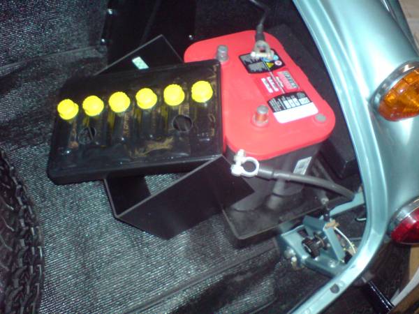

Cannot remember if i got the 34 or 34r, optima's are difficult to get in the uk. The terminals are the wrong way round (couldnt get the right one at the time), but I thought whatever battery I got would be wrong (negative earth). I did get a tar topper from the US to hide it a bit, and with a lucas sticker and the bj8 vinyl cover should look period?

just need to buy the vinyl cover and sticker
I take it the bt7 still has the wood block to keep the battery from the wing, your positive earth shouldnt be a problem, your terminals will be on the other side about where the yellow caps are

:iagree: OLIN
Just turn the battery around like Andy says. Access to the terminals for servicing is no problem.--Keoke :cheers:
Andy, looks like you have the right setup. 34 if it is a (-) ground and 34R if it is (+) ground. I picked mine up and it is the 34R and will be positioned like Andy's after I install it on my (+) ground car.
Keoke, I did turn the original around at first, but the terminal were in an inconvenient place. I like to have access to put a wrench on it or jump-start without concerns of grounding the hot side against the fender.
Still sorry for my misleading information earlier... I forgot that I deliberately picked a battery that would put the posts towards the outside on a negative ground setup. So I guess I did pick the post location that would be correct for a conventional positive installation. I was trying to maximize every bit of trunk space I could. I even shaved down that wood block a bit as well to push the battery further over. It still seems like I could get to the posts safely if I need to jump someone, and it's an AGM battery, so don't need to worry about servicing. Putting the posts towards the outside really didn't help with the space any, but I just wanted them out of the way... looked cleaner, and less chance of anything in the trunk accidentally striking them.
~Robert
Good call Robert, I did all those things to my cars too and had no problem getting access to the battery terminals for repair ,charging or the occasional boost. I thought you had a neg ground set up
judging by the battery terminal size and location.--Keoke
