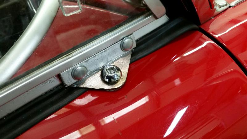

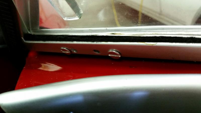

Attached are two closeups--in and out--of the right side curtain. The brackets that came from NICAL were made from aluminum with pins that slipped into the two sockets. Because the metal flexed and the pins were a loose fit the side curtains were not very rigid and pulled away from the windshield at speed.
The bracket shown is temporary, made from thin steel for rigidity and I plan to go to stainless steel for the final version. I ran a 3/8" coarse thread tap into the sockets and the button head screw allows me to draw the side curtains very securely to the door.
All told, the curtains are a pretty good fit.

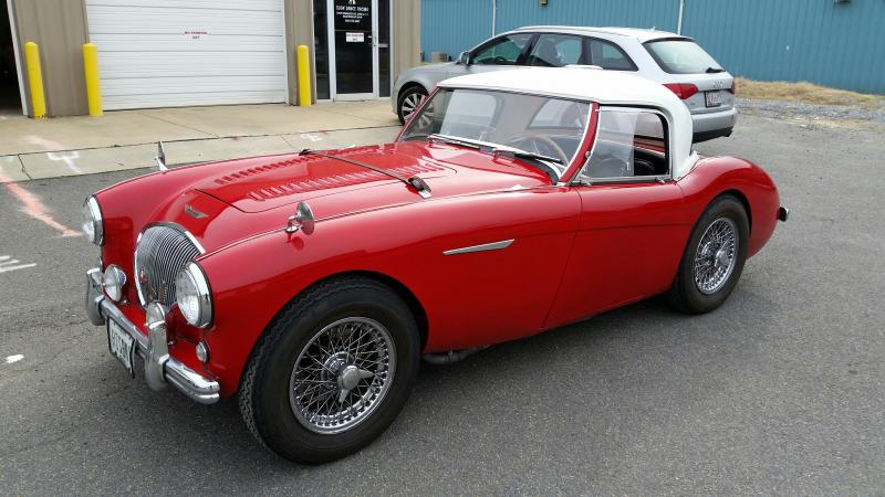

In addition to a couple of tops for later cars that he was delivering Freeman brought with him to Conclave W-S one 100 top which I bought. He and I spent the better part of a day mounting it (without the rear window) so I could drive the car. Installing the rear window was a difficult job in part because the shell is very thin and would distort under the pressure needed to work the rubber seal into place. I finally purchased a couple of the metal bars which essentially triangulated the rear window opening and stiffened the top sufficiently.

I really like the look of you car and hardtop!
Thanks,
Duane
Duane--
Thanks. Since the heater works wonderfully and the hardtop and side curtains are very snug I am able to use the car all year long.
