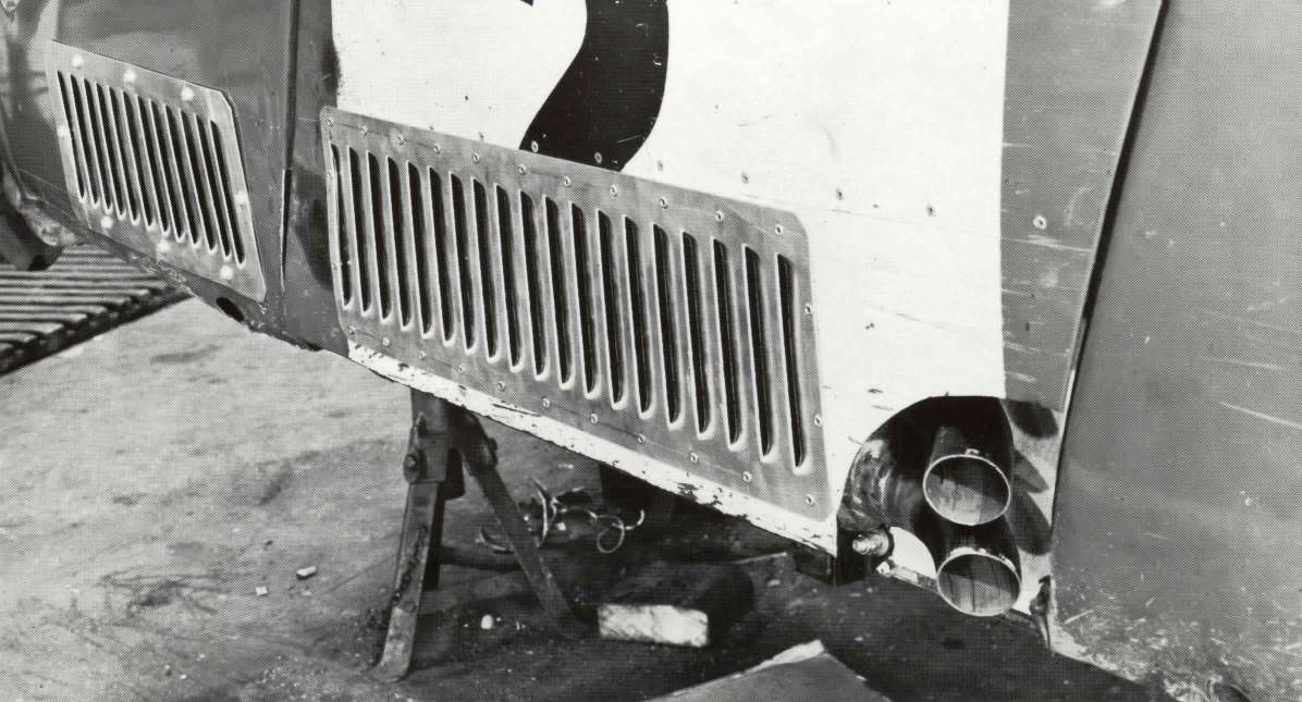

...and a close-up photo with the wing off...

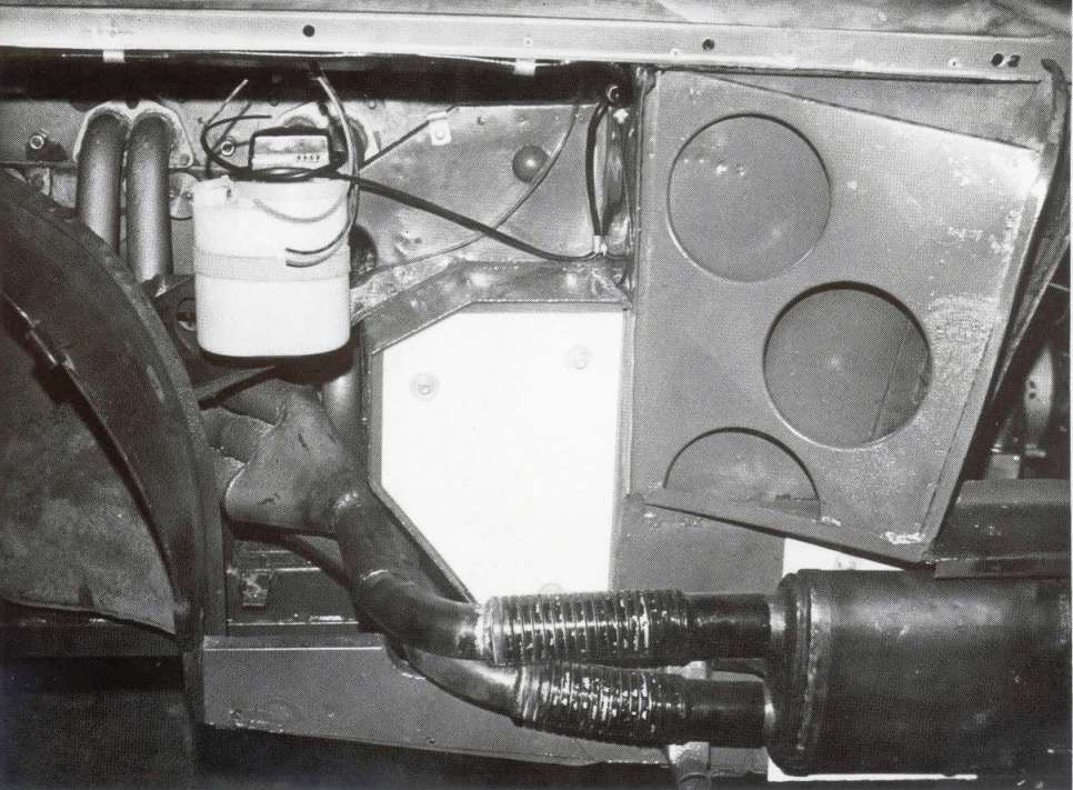

I switched to a DW side exhaust when I fitted his headers. I was changing to a more competition 'look' and removed the bumpers at the same time. I think the side exhaust gives a cleaner profile and suits the bumperless look.
The noise is not necesary louder but it is different. Firstly there is more resonance as the old cast iron exhaust manifolds act as a resonance sink. The second difference that I noticed is that there is no distinctive change in exhaust note around 2500rpm as with the standard exhaust. Thats a downside because I really liked that change of note to a rasping sound that really bounced of walls and tunnels.
The side exhausts mounted in the sills as per Reid's photos were only installed right at the end of the 3000's Rally life. You'll notice that car is a BJ8. The famous 3000s driven by Moss etc did not have these, they had normal side exit exhausts
