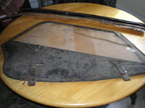

Here is a picture of the side curtain. I noticed that the sliding panel does not have the handle on it.

More add-on info. There is no rubber on the outside of the exposed frames and the frames are all steel and the brackets are welded to the frame.

On original side curtains, there should be no exposed frame. They are entirely covered by vinyl. The front window (very thin) should be sewed into place, with the rear movable, which should have a handle on it.
I've seen the Amco side curtains, and the frames are made from aluminum without any vinyl covering the top section.
Edit: If you are going to send them to TRF, they will do them as they are supposed to be. Just make sure that they fit your car correctly before you send them out, as it's difficult to adjust things after they are finished. I swapped a set with with Paul Bos from the forum (i needed Dzus, and he needed wedge), and had to tweak them a little to get them to fit. When I get the money, I'll send them to TRF.
Geo Hahn
Those look like original curtains to me though I don't see the little strap that snaps to the door (might have been removed, maybe not all had it?) and you say the handle on the slider is missing (could have broken off, was probably just a tab of plastic that curved away from the window).
IMO, the 'right' looking color for the side curtains is the same color as the top... i.e. black with black or white with white. That (the top) is more noticeable than the interior color when the side curtains are in use.

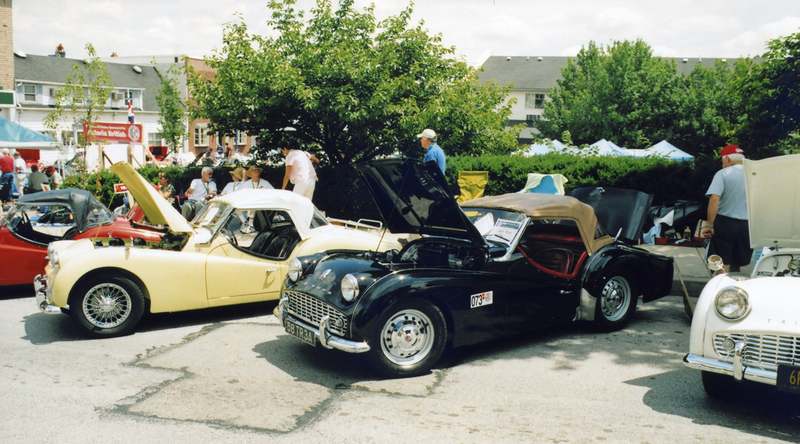

When I bought the new beige top for my 1958 TR3A in 1988, I bought a Robbins top from Roadster Factory. When I had them re-build my sidecurtains (really it was Larry Learn who did them at that time), I specified the same Robbins vinyl and it matches my top perfectly. Here is my top in 2007 at VTR in Valley Forge PA. You can see the sidecurtains displayed as per TRA near the rear fenders.
