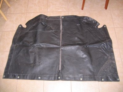

Drew if you havn't already boxed the tonneau up, can you take set of reasonably accurate measurements and some more pics? I'd like to make one, it'd be a good project for the cold months.
I've been looking at ncbugeye and was wondering what purpose the two cutouts serve. There doesn't seem to be any part that has to be cleared at that point just behind the edge of the windscreen. Any idea?
Also if anyone else has a "long" form tonneau please take measurements of that and post pics too.
Chris - it's already boxed up and ready to go out in the mail tomorrow. I'm sure Jack will be willing to measure it up for you when it arrives in FL.
Don't know what those cutouts are for, either. I put it on Tunebug and it did seem to fit but those details seemed to be extra. I guess we'll see when Jack gets it installed on Ms Agatha.
Drew's pic is taken with the front of the tonneau at the top of the picture - you can see the pocket for the top of the steering wheel at top left. Also the zipper zips from the front.
The cut-outs are for going around the windshield stanchions. Remember, the sides hang over the door at least a couple of inches on the sides, and go pretty much to the windshield base across the front! I do remember the original on my old one was not as square at the back though, following the radius of the rear corners of the cockpit somewhat to snaps across the back!
