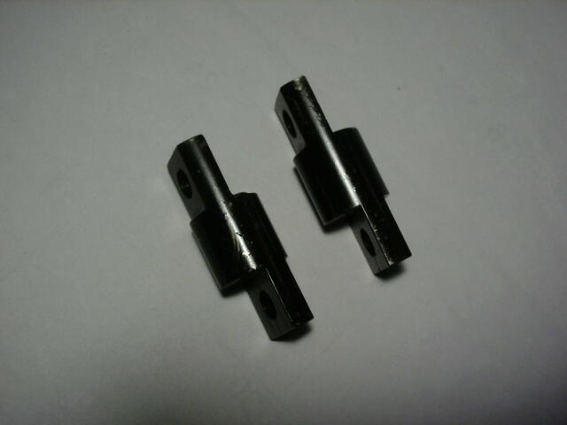

I’m not familiar with the TD - and it is not clear to me how the Moss extenders work. Do they push the upper pivot point forward, pushing the pedal below backward?

The clutch and brake pedals are already set up for the extenders, but the gas pedal is not. As in a previous post, these are a short pair of extenders, they made longer ones like those in the picture. I think they came in three lengths, not sure. My TF has a pair of short ones on it. PJ
From the Moss and B&G photos, seems it's easy to fabricate those someone can weld.
Anyone up for the job?
I can give you dimensions. I have two short ones for my car
Thanks. I think the bolt hole diameters are the most important, plus the Width and Length and Thickness of the bolt hole stubs. Total length of the unit probably rests on how much the new owner actually needs. (I'm referring to the Moss photo)
Still need to figure out how to "extend" the throttle pedal. Seems a wooden, plastic, or metal block, with a curved rear surface, fastened to the original pedal with bolts on left and right, would do the trick.
