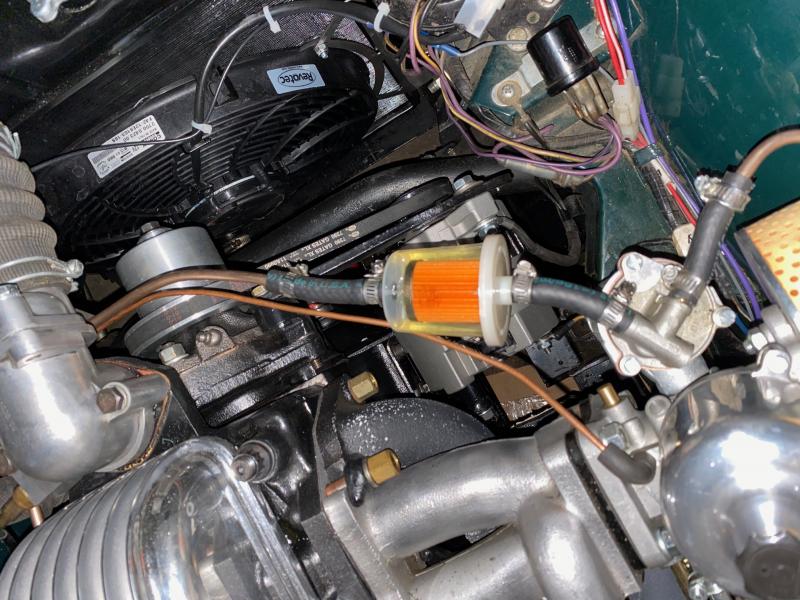

That's the ticket. I removed the POs black paint and heavy dirt with a wire wheel and then a Dremel to get into the nooks and then a lot of hand work with metal polish and super fine steel wool. A power buffer after that would really shine it up. I didn't do that, as can be seen in the attached photo. Not show quality but OK by me.

Isn't that fuel filter supposed to be installed the other way around???
No sir. You can't see it in that photo but there is an arrow on the clear part showing the direction of flow. You want the dirt and debris to be trapped on the outside of the filter media where you can see it.
