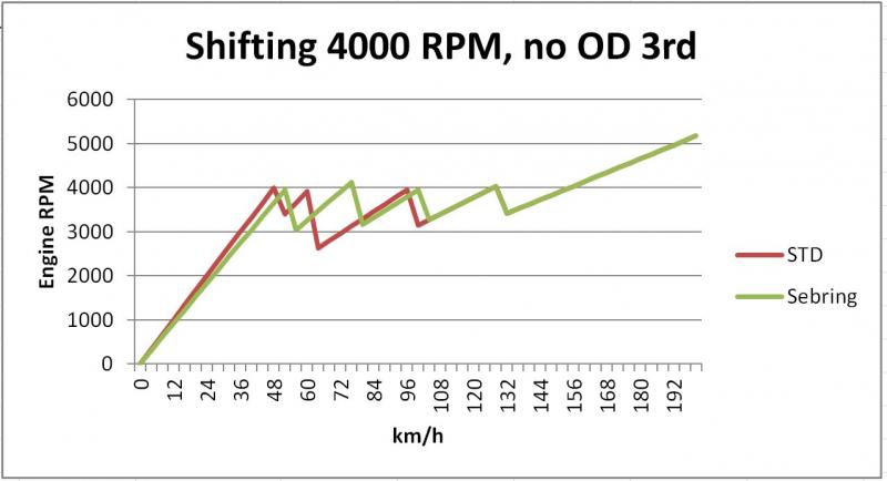

Hi, before taking decision to install Sebring gearset I made a simple analysis between the original gearset and Sebring, see attachment. The original gearset step 1st-2nd is quite small thus making an engine speed drop during gearshift more sensitive.
