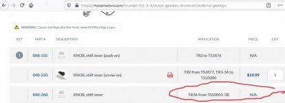

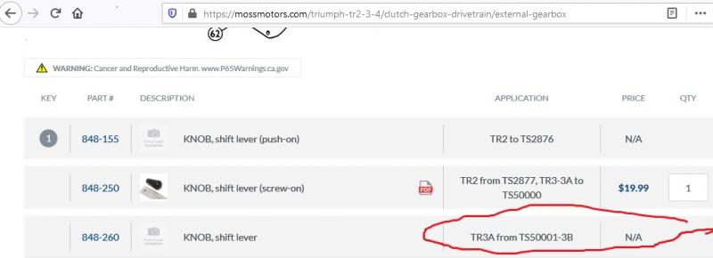

r
That's as it seems but Refer to #1 on the diagram, which indicates that there is a difference:
https://mossmotors.com/triumph-tr2-3-4/clutch-gearbox-drivetrain/external-gearbox
Here's a pic of it.

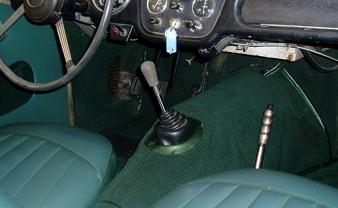

CJD
Here is the early knob...kinda chinsy rubber...
I’m used to holding my palm on top of shifter knobs, but this one is so skinny you have to grip it palm to the side.
