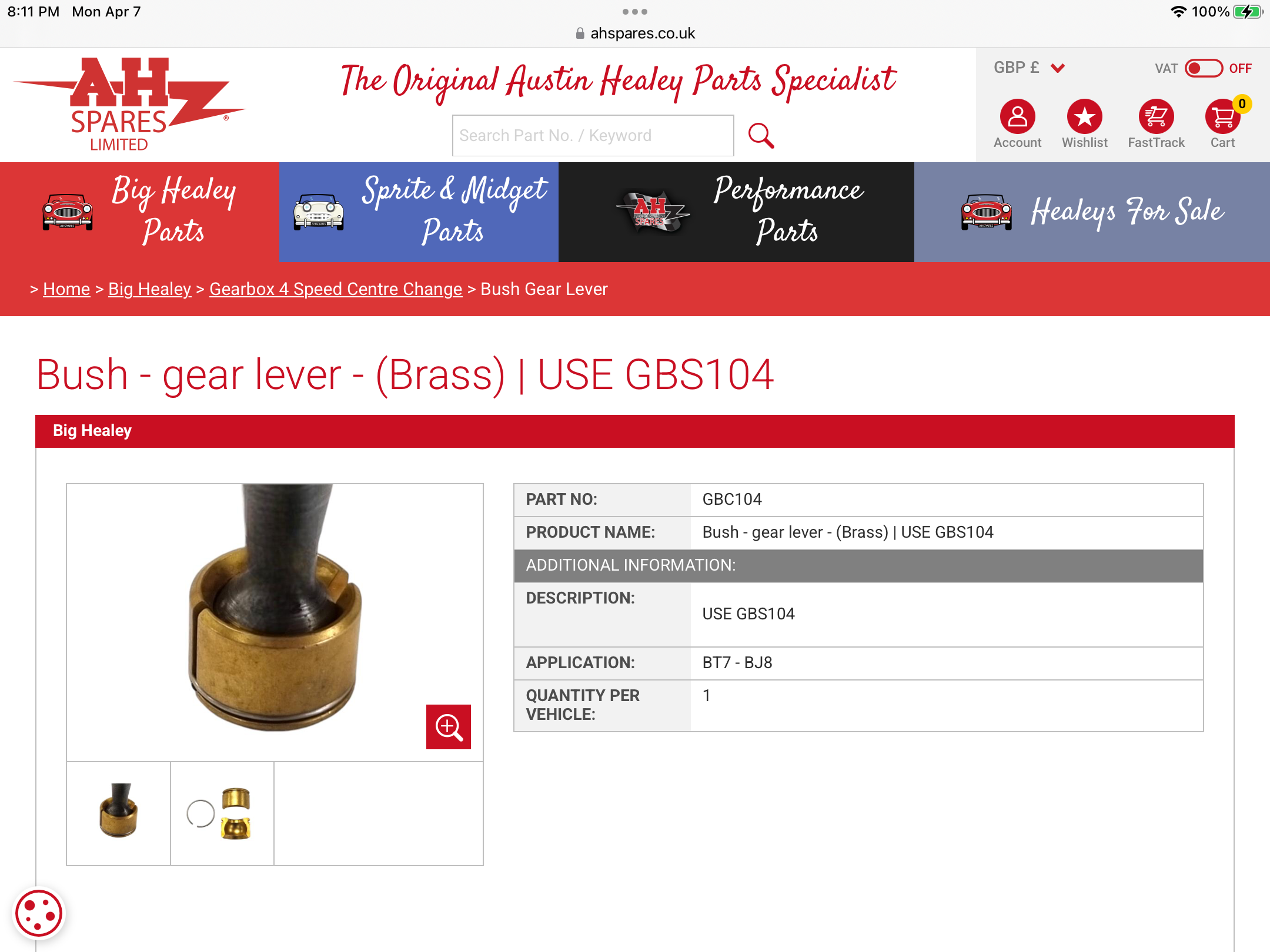

Would a brass bushing fit? All comments seem to say nylon bushing for a BJ8.
Yes it fits . Stick it to the end ball of the gear lever with grease and carefully lower it into place .

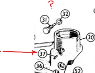

Yes. Original to the car center shift with OD. Excerpt from Moss diagram showing "Gear Lever Locating pin" for BJ8s but roll pin for BJ7s and earlier cars with center shift. Do the roll pins - which are located on both side of the tower- secure the gear lever? Removed circlip and washer and tried pulling straight up on the gear lever, but no joy. Perhaps there's a sweet spot where the pins line up with slot in the gear lever. Thanks

According to Leo Ruof who rebuilds gearboxes and overdrives, you have to drive the roll pins into the shifter ball to remove the lever.
The procedure found on YouTube makes sense and should work for my BJ7 Early Car Center Shift Drive the pins out slightly to remove the gear lever and reverse on installation. Going to give it a try later this week. Thanks all.

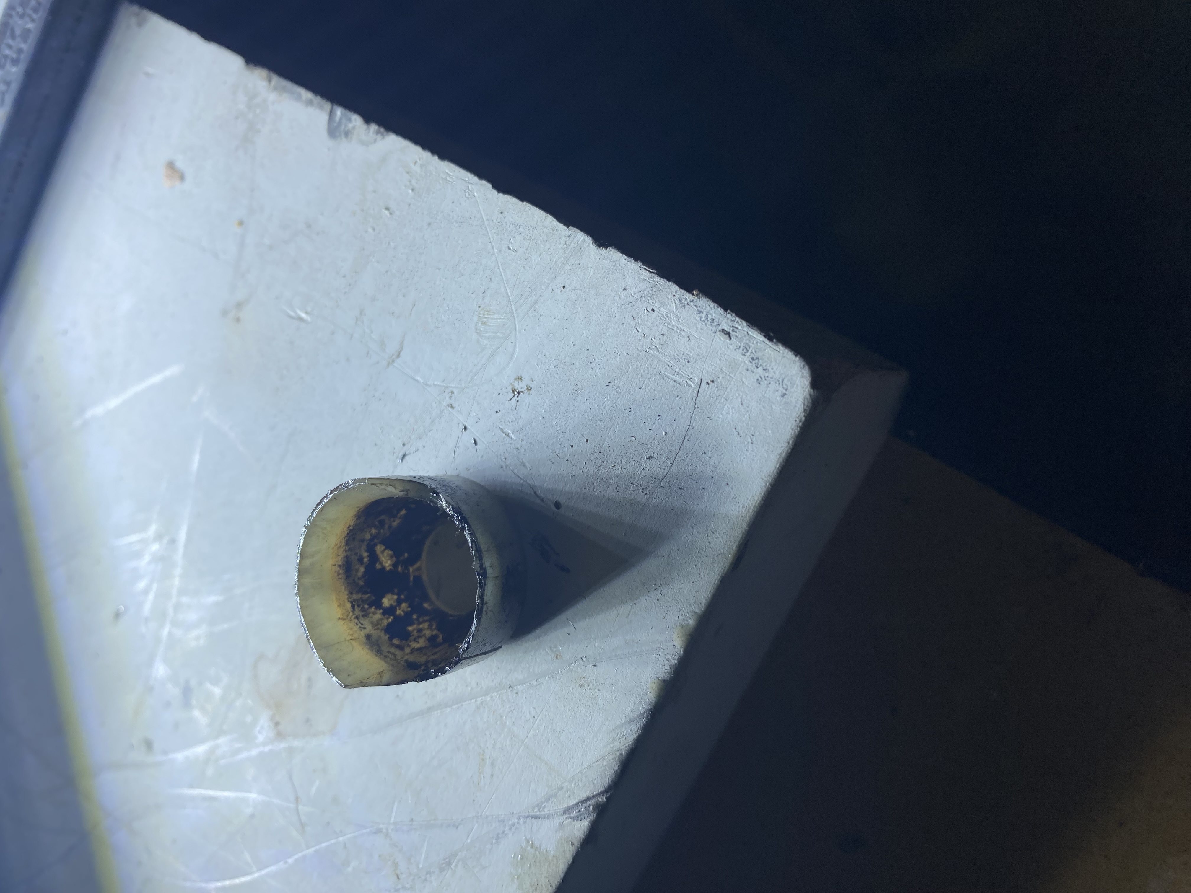

Replaced my bushing with a nylon one. I know the brass one would have been better. The shifting is much improved, not as sloppy and goes into gear a lot better. The problem I have that I thought might have been remedied is the overdrive. It goes into overdrive, slight delay, but does not go out. I tried pushing in the clutch and pressing the gas pedal when I switched the overdrive off. I came to a stop and moved the shifter to the right and the solenoid still clicks. Press the gas pedal again while stopped move shifter to the right and no click. Also getting a slip when overdrive is not off, but switched off. Fresh 40 weight oil put in.
Sounds like the throttle switch needs setting correctly . The throttle switch needs to be set so the OD drops out if you kiss the throttle above about 1/3rd of travel . If the OD switch is turned off the only thing left in the circuit to hold the OD on is the throttle switch .
