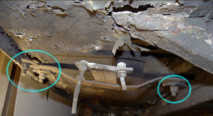

Now, does anyone have location measurements and/or photos of the muffler hanger studs in the boot floor for a BJ8? My Dad had done a quicky replacement of the boot floor 20+ years ago and left them off, switching to a BJ7 exhaust. I may still go with a BJ7 exhaust, but I want the chassis to be correct.
I'm almost positive the Kilmartin floor has the muffler hanger holes pre-drilled. I'll check for you later today.
Yes, the holes come with the part. I pretty sure they even supply the elevator style bolts too. The photo shows where the hanger mounts and the floor comes with three holes.

I got a boot floor from Moss and it does not quite fit. I looks like when they stamped it they did not get the blank all the way into the die, resulting in a little more turn down at the back and leaving it a little short in the front. At any rate before you cut the old boot floor out, be sure you take measurements from the bootwall to the rear of the floor pan.
Hello Richard Dickinson,
I hope your boot floor doesn't have those cracks and holes in it that the picture from GregW. Did you also get the special shaped bolts also in the picture.
Sorry GregW couldn't resist. I'm sure the boot floor really is in great shape and the bolts are just an optical illusion.
Hehe, no worries. That was the way the car arrived here in California. I didn't even take the exhaust off. It fell off onto the carrier during transport it was so rusted.
