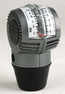

<div class="ubbcode-block"><div class="ubbcode-header">Quote:]and another thing I may do differently is balance the carbs AFTER I've found the best mixture. [/QUOTE]IMO they need to be at least approximately balanced beforehand, as you won't get an accurate mixture reading if one carb is doing all the work. But balance in general is not all that critical; I find that simply listening to the hiss (using a length of tubing if available) works well enough (even though I do have a Uni-syn).
There is a good article that covers adjusting ZS carbs at https://www.buckeyetriumphs.org/technical/Carbs/CarbsIII/CarbsIII.htm
I don't care for the Unisyn. It's difficult to see if it's been placed concentrically over the carb's mouth and if I manage to get it on one, the chances are slim that I get it in the same place on the others.

And the best fit for Brosky's carb balancer is go the local hardware store, buy a pvc elbow(you know the white plastic plumbing kine) that fits over the rubber cone, the other end goes around the intake of the carb. Get a large rubber o-ring while you're in the plumbing side of the hardware store(usually a box of different size o-rings). Glue the oring to one end of the elbow...
Now you get to put the elbow with the oring on the carb face, drop the balance tool in the upper opening of the elbow and you have a great balancing tool(that fits keihin motorcycle carbs, Webers(at least the dcoe's), SU's Zenith Strombergs, etc..
