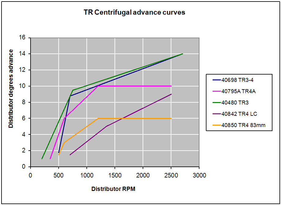

The springs are not really "return" springs at all, but rather they determine the amount of centrifugal advance by resisting the force exerted by the weights. The heavier spring is supposed to be loose "as installed", since it only comes into play at higher rpm (giving slower advance above a certain rpm).
So it's not important that the springs pull the point cam all the way back against the stop (it will be pulled there by friction from the point rubbing block even without the springs).
Moss should be able to tell you which springs are suitable for which distributor.
Here's a little chart I made some time ago, showing some of the different factory advance curves
