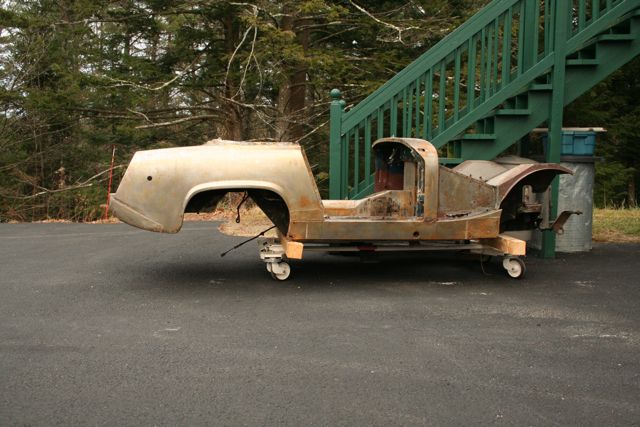

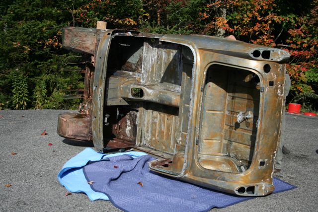

This is a '70 Midget that I stripped with the help of a friend. It took the two of us (I'm guessing) 25 hours working at a leisurely pace, and I spent about $300 in paint stripper,gloves,pads,brushes etc. Still would have had to sand-blast the front rails.
No big deal. I'd do it again to the right car, under the right circumstances...

Btw. That stripped body looks great.
