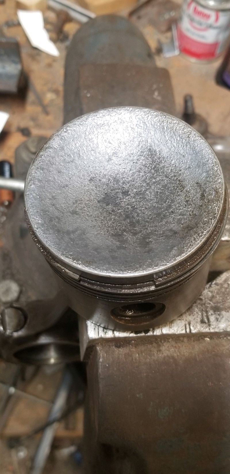

The old pistons look like they were not machined on top?? Note the huge gap in the top piston ring. Looks to be about 3/4". It may have been broken and I dropped the piece. One of the other top rings was in 2 halves.
