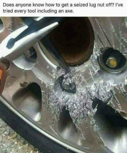

Searching the picture on Google and there are a lot of theories that this is a wheel lock issue without the proper socket. I would've thought a long breaker bar would've worked if this was an ordinary nut. My son had that happen with a CPO Civic that turned out to be missing the key when he changed tires. Took the dealer 3 days to get a new one in.
Saw one like that when they lost the key and a shop said "no problem". Didn't call me first...I have the special socket to get those off. Beat in on over the nut, breaker bar off (and check a regular nut to see direction).

How do you do it if it's not an acorn lock nut?
Drill the wheel stud out right down the middle, Keep increasing bit size until the nut comes free on the bit. Put in a new stud and nut.

Don't know if it is applicable, but most tire shops have tools to remove lock nuts without the key.
